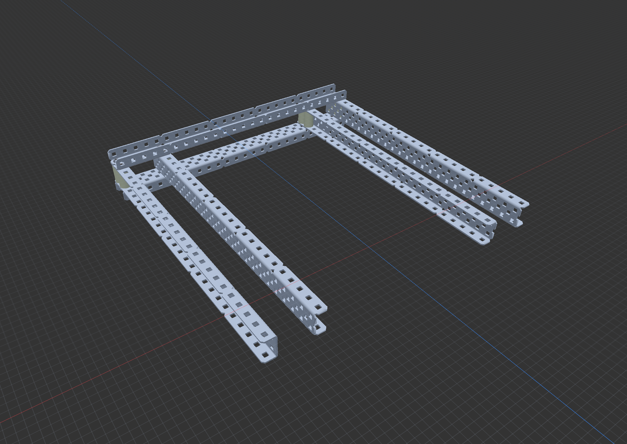

I took it on a bit of a spin to make a basic frame for a chassis
I really like the part selection, I think this is probably the biggest advantage this has over traditional cad software. I also really like the screw-centric constructing, its an interesting alternative to the mating system other programs have, although like @djavaisadog said it could use some streamlining.

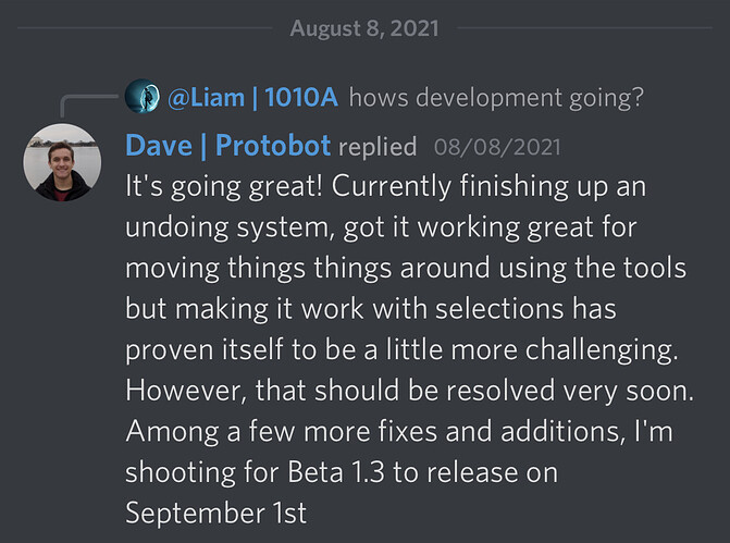

Hey, @DaveG, is there an update on when the windows version will be available to download? The patch notes seem to indicate that the download is already available, but the download button on the site says “coming soon”, and sends me back to the top of the page.
Any news on this? I have heard nothing from him, or anywhere.
