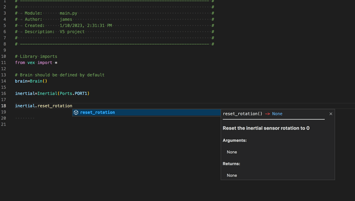

yes, reset_rotation() and reset_heading() are both available, remember all Python functions use snake case style. I recommend you use the VSCode extension which has improved intellisense for Python functions.
