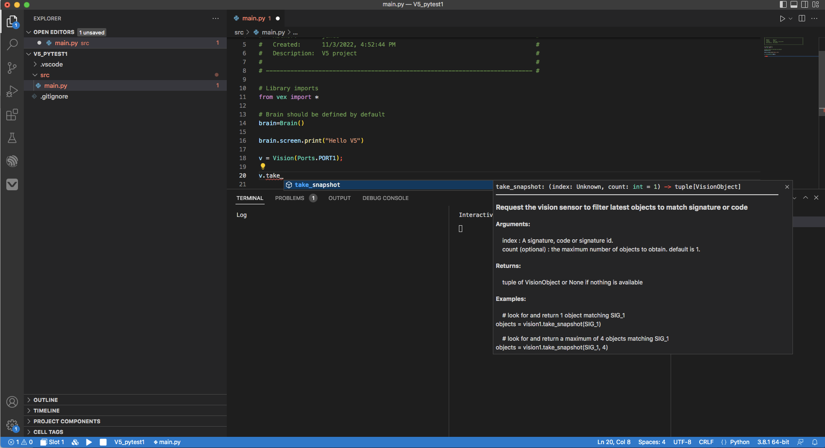

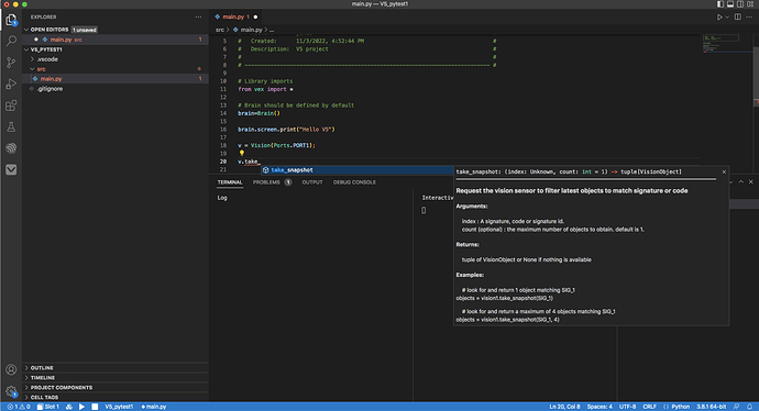

If you were programing using the Visual Studio Code extension then the intellisense would have helped.
Otherwise I’m not sure if/when VEXcode may improve its help system, and yes, help for take_snapshot in VEXcode Python is pretty useless.
