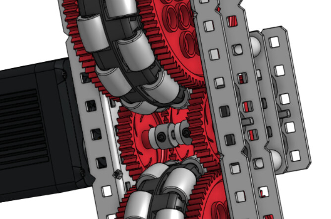

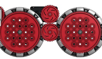

(Bottom & side view of our CAD):
The motors are connected to the axles (on the 36 tooth gears). They spin the 84 tooth gears on the screw joints (the 84 tooth gears are fastened to the omni wheels)
Yeah, but if it isn’t screwed in, everything on it will just wiggle around and maybe the screw will even fall out. But, what I meant was that the nuts there are unnecessary since there is already the standoff. If you replaced the nuts with spacers or washers, it might decrease some friction since metal isn’t rubbing against metal.
well the wheel and gear spin on the wheel and the screw doesnt move so i don’t see where metal would be rubbing on metal
Question, why do you have gears on both sides of your wheels? I think its fine if you only have gears on one side.
Backup redundancy. Since we don’t like cutting parts (except aluminum, we have a lot of that), and we wanted to screwjoint our wheels, we opted to not drill out expensive VEX gears and instead utilized 3d printed PETG ones (modified to have a screwjoint hole).
Needless to say, we were kind of wary about it snapping (especially since the filament was kinda old), so we put two gears for redundancy in case one side failed.
