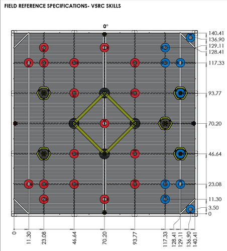

If I subtracted 2 numbers would that be the distance in inches or millimeters. Or is it just the degrees.
Look at the bottom of the page:
“ALL DIMENSIONS ARE IN INCHES.”
Yes, inches. This drawing uses a system called “ordinate dimensions” and each number you see is the distance, in inches, from the “0” point or “origin” in the bottom left corner.
