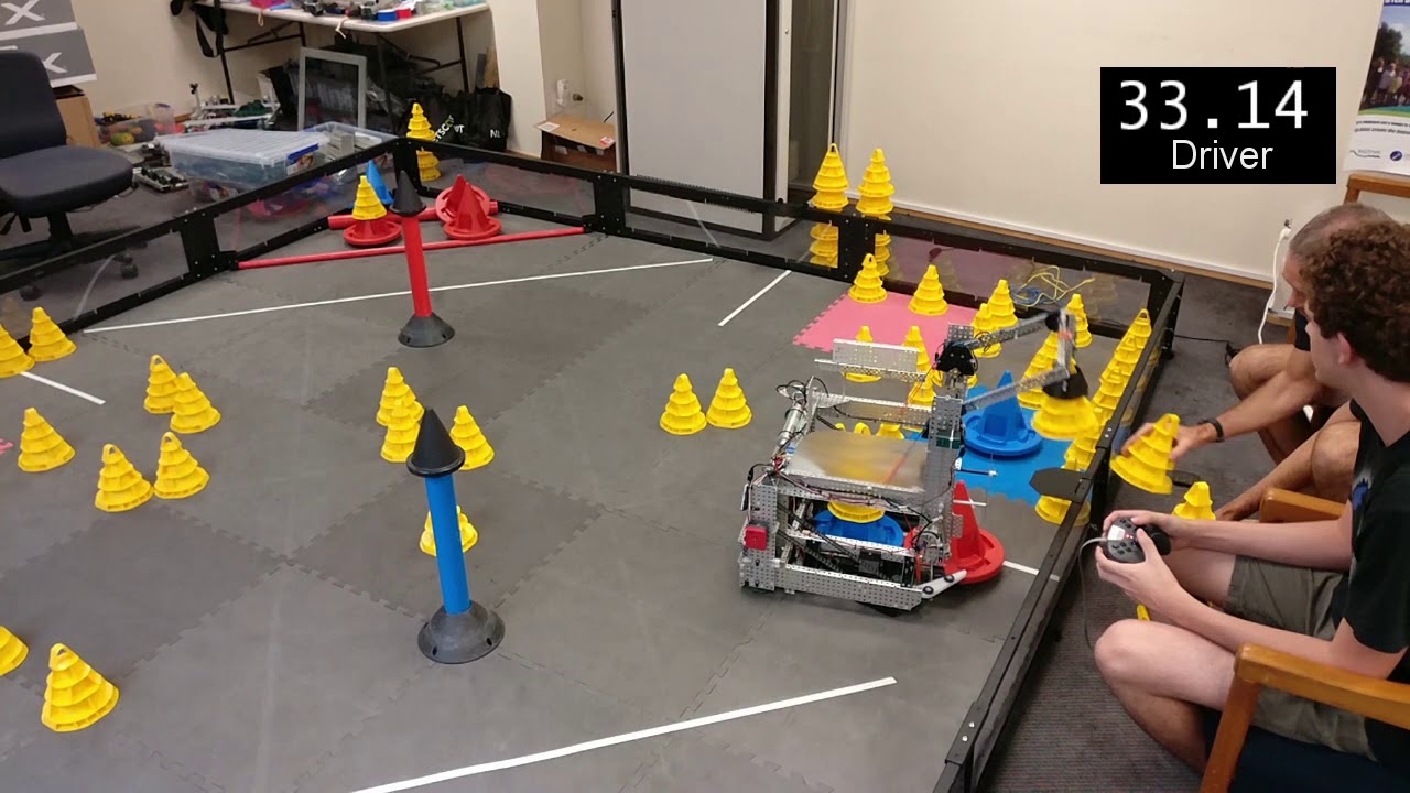

If you are doing all omni wheels, you can use a taper on the front of your base and drive into the corner and it should align itself perfectly.
See an example here:
365X used “wings” which allowed them to perfectly align with mobile goals during ITZ. They popularized them for use in VRC. I remember some teams using them in Change Up as well
We are using all Omni wheels, luckily. I’ll forward the video to our team leader, see what he thinks.
2011D did it too, you can find a video in their public google photos album:
Of course, not really an option this year because of no expansion, but the principle should work.
