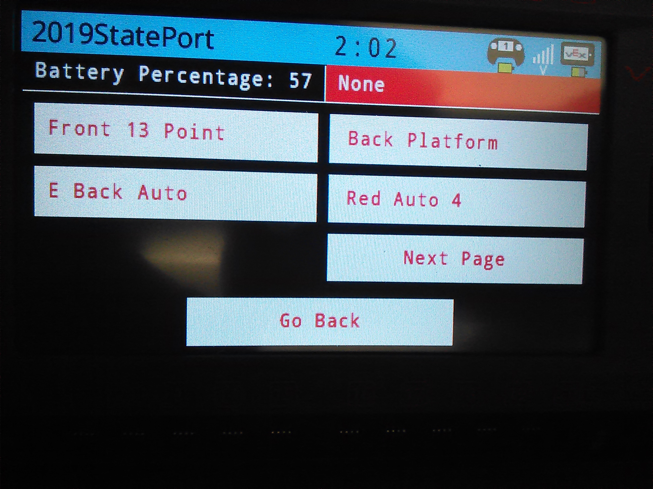

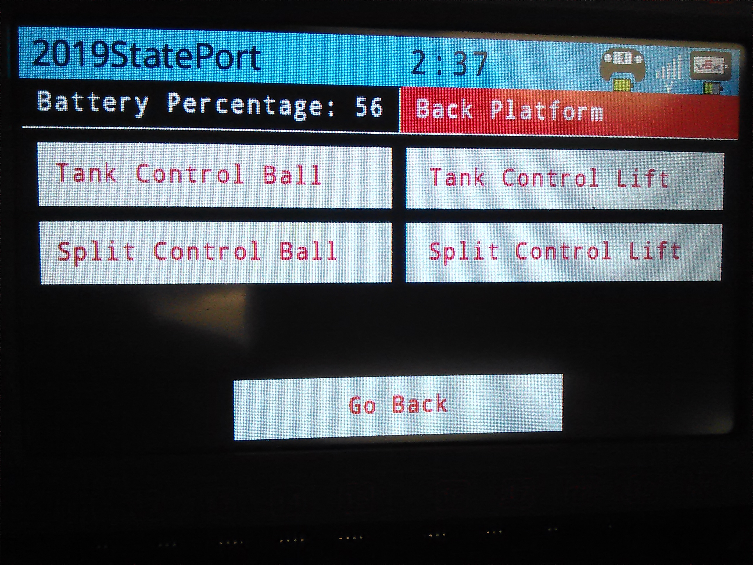

Below are some pictures of a GUI I developed. (Sorry for the quality) I am trying to develop a similar GUI in PROS.
How do you change the size of the LVGL buttons and colors?

lv_obj_t * myButton= lv_btn_create(lv_scr_act(), NULL);
lv_style_t myButtonStyleREL; //relesed style
lv_style_t myButtonStylePR; //pressed style
function createButton()
lv_style_copy(&myButtonStyleREL, &lv_style_plain);
myButtonStyleREL.body.main_color = LV_COLOR_MAKE(150, 0, 0);
myButtonStyleREL.body.grad_color = LV_COLOR_MAKE(0, 0, 150);
myButtonStyleREL.body.radius = 0;
myButtonStyleREL.text.color = LV_COLOR_MAKE(255, 255, 255);
lv_style_copy(&myButtonStylePR, &lv_style_plain);
myButtonStylePR.body.main_color = LV_COLOR_MAKE(255, 0, 0);
myButtonStylePR.body.grad_color = LV_COLOR_MAKE(0, 0, 255);
myButtonStylePR.body.radius = 0;
myButtonStylePR.text.color = LV_COLOR_MAKE(255, 255, 255);
lv_btn_set_style(myButton, LV_BTN_STYLE_REL, &myButtonStyleREL); //set the relesed style
lv_btn_set_style(myButton, LV_BTN_STYLE_PR, &myButtonStylePR); //set the pressed style
lv_obj_set_size(myButton, 200, 50); //set the button size
Also here is a tutorial that I made tutorial. It explains all the basics of lvgl.
Instead of calling LV_COLOR_MAKE you can also use one of the built-in colors such as LV_COLOR_BLACK or LV_COLOR_WHITE
In the snippet above, the last line is the answer to your question.

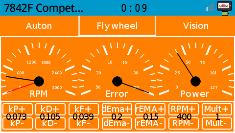

Btw, here is a PID tuner I made for our flywheel. It uses lv_btnm, lv_label, and lv_gauge.
The decimal modifier can be changed by Mult.
I will probably release code at the end of the season.
The code for this is more than I am willing to paste at this time. I showed that demo to show what lvgl is capable of, you could probably make something similar. I employ the use of many C++ utilities such as tuples and string manipulation, and is part of a greater library I don’t want to release quite yet.
At the end of the season I will likely release most of my code, but with proper documentation and comments.
