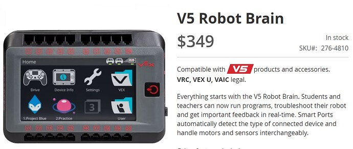

How is it possible that hardware is identical?
The regular V5 brain sells for $349 V5 Robot Brain - VEX Robotics
While the Smart Field Controller Kit listed at $169 Smart Field Controller Kit - VEX Robotics
There got to be something different or are you saying that the freedom to write your own code costs $180?
:thinking:
Or you disable core functionality so EPs can run events using match controller that offers a lot of possibilities that old control system does not.
I would recommend teams that were at Worlds look at their V5 Brain Event logs - lots more going on to help EPs debug field issues. I know I will not go back to old VEXnet field control system.
I think this is the right approach to get more adoption of V5 for field control and using SBC like rPi … nimble and effective on all fronts.
They could also view it as a loss leader. How many Brains will EPs buy in support of competitions that bring in teams who buy full feature and full price brains.
That isn’t a smart buisness decision. I would rather believe that the true cost of V5 brain is less than $169 and an ethical choice would be to sell it, like, for no more than 20% markup, plus s&h. Not a 50% markup for a product that is notorious for burned motor ports, that for many teams becomes unusable around the time when the warranty runs out!
Imagine buying a $169 kit. Then swapping out the power board to an old V5 brain with a bunch of burned ports.
I think VEX has in the past provided V5 hardware virtually identical to production for free - it was called BETA Units - they had same hardware but different color cases. No one complained about smart business decision - it was a business decision to validate the platform before producing lots of them. This business decision is to allow EPs adopt new field control platform at same cost as previous system. Having different packaging and VEXos verify that the unit is to be used for field control is a good one (vs Beta which inspectors had to check if burnt in branding BETA UNIT was present).
I do not have the three versions of V5 Brains in front of me - so I can not say 100% certainty what is inside. What I can say, V5 Smart Field Controllers were more stable for match control than using V5 Brain with Field Control app.
The good business decision was to have clear marking on device and VEXos checking the device to determine if V5 Robot Brain or V5 Smart Field Control.
Vex already gives EPs a discount on field kits, I believe of 50% (perhaps that’s just for one kit per EP, I’m not sure), but that’s pretty close to the discount they are offering the “Smart Field Controller” compared to the V5 Brain. My guess is some number of these SFC are RMAed / warranty-replaced Brains that Vex may be recycling after replacing burned ports, reskinned, re-burned, etc.
There are fair criticisms out there for Vex, I just don’t happen to think the SFC Kit is one of them.
Even if my analysis above is wrong, many smart businesses use “loss leaders” all the time to drive customers to products that ARE profitable.
That’s a strong statement to make with no insider knowledge of VEX’s costs for manufacturing the V5 brain.
While you can “believe” whatever you choose, that doesn’t make it true. For example, let’s take a look at the cost of a component used in the V5 brain, the Zynq 7000 series processor/FPGA. That single component can cost between $80-$100 alone. There are thousands of components inside the V5 brain, all with wildly varying prices and supply chains. I would be shocked if the smart field control kit was being sold at anything better than a significant loss.
A 20% markup on what, exactly? The bill of materials cost alone? What about assembly? What about manufacturing logistics? What about shipping/transportation? And how do you plan on recuperating the years of development costs? Electronics margins do not work the way that you would immediately think, especially very specialized products like the V5 brain that, while they may seem like they sell a a lot of units to us, ultimately are barely a drop in the bucket of the volume that the Apples and Samsungs of the world can push every single year. VEX is not getting preferential contracts with their suppliers over Apple.
Seems a lot more expensive and complicated to me than simply sending the damaged brain back to VEX to be fixed for their standard $80 repair fee:
I don’t think this price reflects some kind of grand product segmentation plan by VEX. I think it’s as simple as, the old field control system cost (and costs) $170, so to make sure EPs don’t have to redo their budget and to drive adoption of the new system, the new system costs $170 too. The system would be DOA to EPs if it reflected the true costs of manufacturing and cost $350 a pop, and it would be unsustainable for VEX to sell a fully functional V5 brain for $170.
