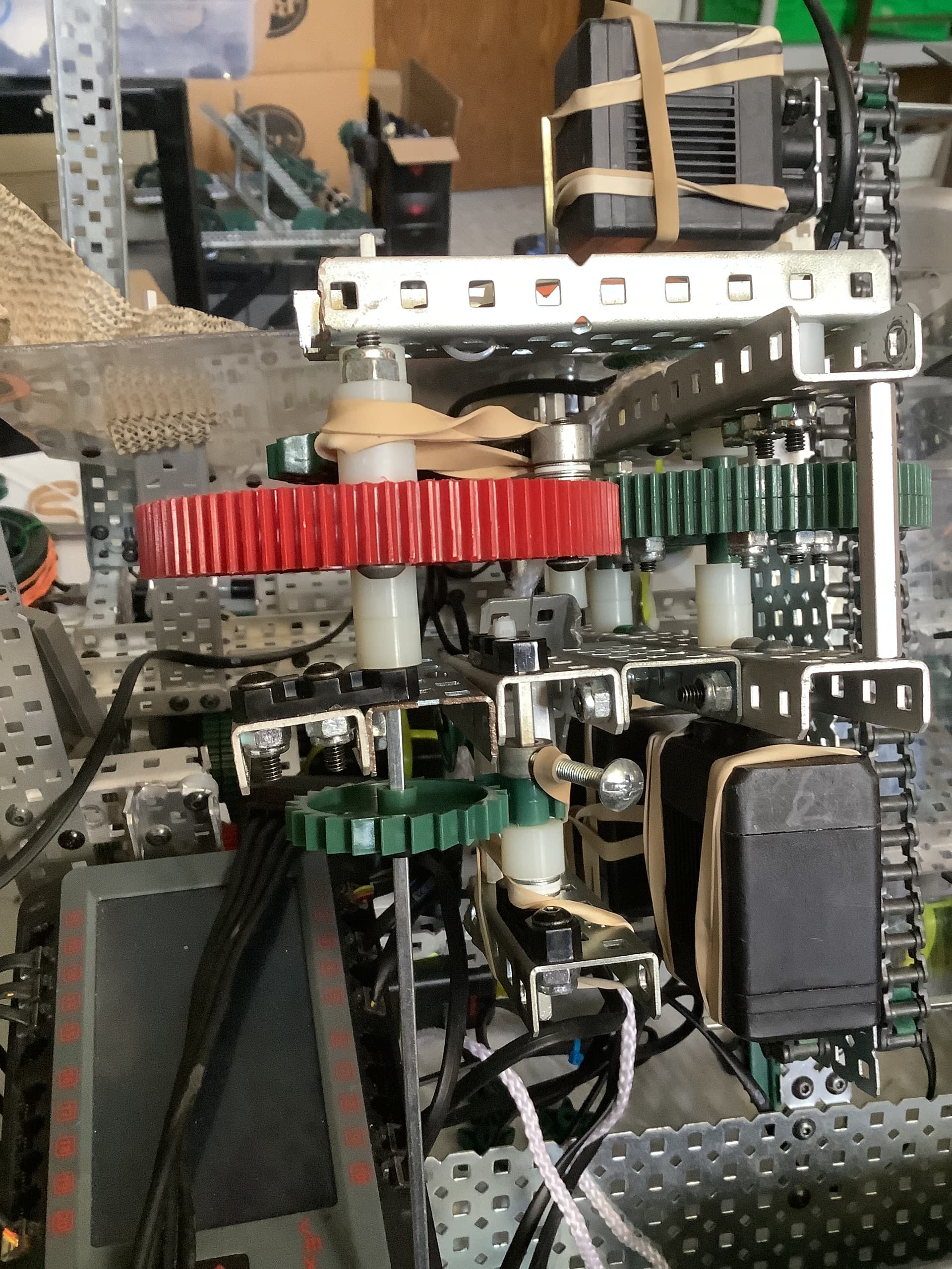

I have been building a 2 motor ratcheting flywheel but making it spin the intake. its not hard to do and if you would like I can send pictures but be prepared half my shop already wants to kill me with the sounds it makes. I’m also guessing your doing this because you don’t have pneumatics?
I’m using a ratchet on my two motor flywheel as well to activate endgame, I’ll send you a picture at the end of school

Sorry if I misunderstood your question, but logically speaking you really don’t need a ratchet for this at all. Since it will we end game, i wouldn’t matter if your flywheel went in reverse anyway. You could just spin both motors in reverse together anyway, just make sure you don’t do it early. Anyhow, a ratchet would work generally the same on a two motor system as a one motor system anyway so long as it is added at the end of the gear train. Sorry for the late response btw.
