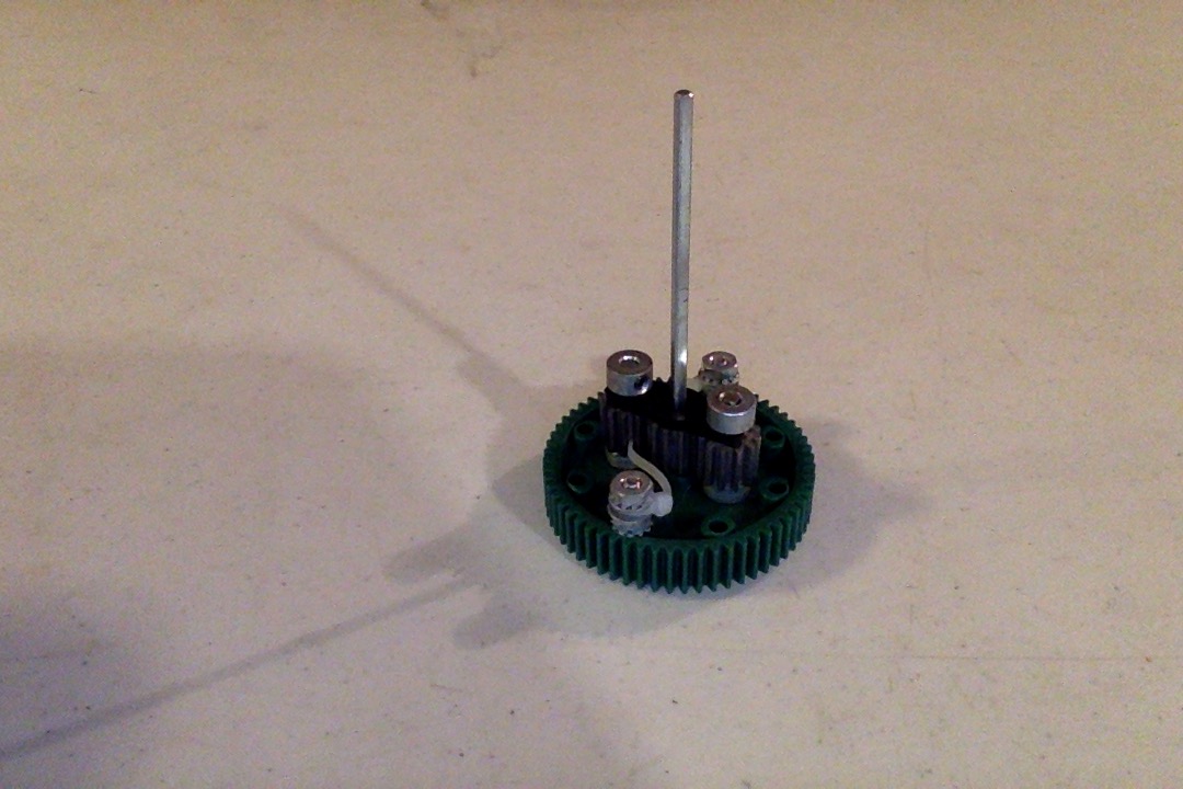

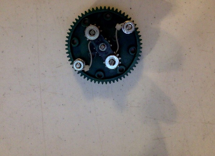

Here is a 60t ratchet i innovated from a thread mid NBN season. It can’t back off and has a fairly high number of clicks per revolution.

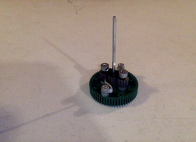

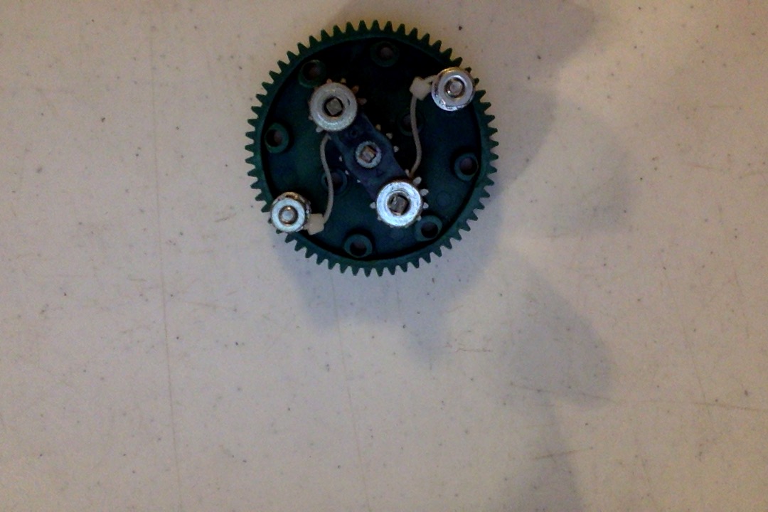

Here are a couple photos of the ratchet. I can also post a video of it working if you want.
The ratchet I posted was a modification of 3211H’s. I didn’t like how the zipties would occasionally pop out, so I modified it so it can’t back off without twisting the axle.
