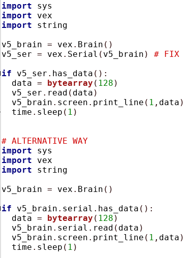

Reading VEX V5 Serial Port using Python
I have connected a Raspberry Pi to the mini USB Port.
On Pi, if I list /dev, I see /dev/AMC0 and /dev/AMC1.
I have few questions:
  1. Rrom Pi, which of these ports should I send dsata to so I can read on VEX V5 Brain?
  2. What Baudrate, Stop Bits, Parity Options should I use?
  3. On the brain, how do I read this data using Python?
    I have looked at the following link for the API:
    VEX V5 Python API: vex.Serial Class Reference
    def init (self, parent)
    def write (self, data, null_terminate_string=True)
    def read (self, buffer)
    def has_data (self)
    I get an error trying to instantiate vex.Serial()
    What value of parent field should I use?

Q1 ? I meant question 1, the answer is that you need to use /dev/AMC1 as that would be the serial port that user code can read.

Current Issue I am getting is when creating the object.
It might be because of missing input.
What is the parent input for vex.Serial(parent)?
Hm, very much not the same. There are some similarities but RobotMesh is based on Python 2.x and VEXcode Python on 3.x (full disclosure, I wrote the VEXcode Python VM).
I would say, based on the RobotMesh documentation, you should be using vex.Serial.write etc. directly and not try and create an instance of the class. but as I said, you need someone with more RobotMesh experience to respond.
The person I was working with told me that the problem can be fixed by passing an instance of the vex.Brain() as parent:
Based on that, I think the Alternative Way below, would work too…
