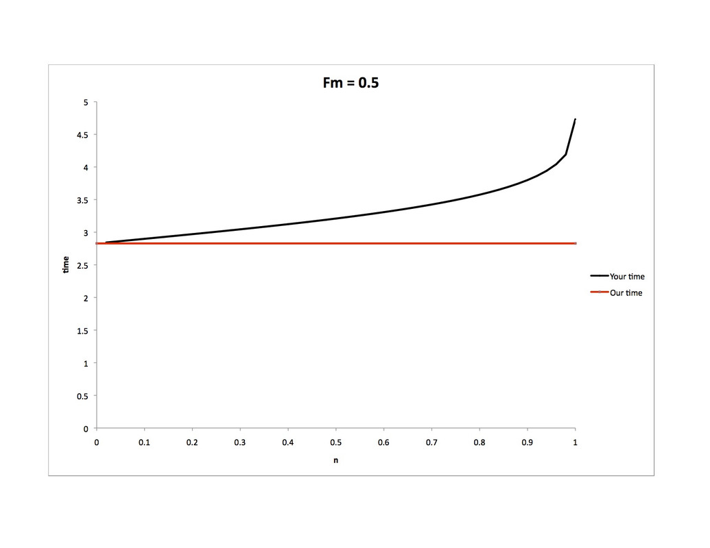

Actually, I understood you really well. But some of it was that I recognized a physics error you were making and just didn’t have the time to also address that. But since that’s what’s getting in the way now, I’ll address it. I’m going to try to drastically simply things to show this one issue more clearly. The way I’m going to do it is to estimate all force changes as linear and to use the “resultant force” approach @meng is explaining to you, so a lot of what I’m saying should be addressed with torques and I’m avoiding it to highlight this one issue.
First, let’s assume you have no extra load at all and that you have no special catch mechanism to hold the lift down to keep it legal before the game starts, just that the elastics are just shy of pushing it up on their own, perfectly balancing gravity at the bottom. We’re also dropping every bit of friction.
Now also recognize that the motor doesn’t care which direction it’s going. It can create the same force in either direction.
So your approach is to set the elastic force as Fe=Fg at the bottom and decrease toward some fraction of Fg at the top. Let’s let it lose n*Fg at the top, leaving it flexible to go to 0.6Fg (n=0.4), 0.2Fg (n=0.8), etc. My and @meng 's explanation of “uniform resultant force” would have Fe=Fg everywhere. So yours becomes ours if your force drops to Fg (no drop) at the top, if n=0. So the question is if n>0 helps or not. Let’s say the motor can produce force Fm. Meanwhile, we’re accelerating the same mass M upward. So let’s see which method can get the mass some fixed distance h in the least time. Let’s call x=0 at the bottom and measure x upward.
Your upward acceleration would be (Fm - (x/h)nFg)/M for the first portion, and (-Fm - (x/h)nFg)/M for the second portion. Our method would be Fm for the first portion and -Fm for the second portion. Note that rise h will not be split into the same sized portions between the two methods. Our method will split it equally, while yours will not. Our method will take a time of t=2sqrt(hM/Fm) (Lots of calculus and algebra later…) Your method’s lowest time will be accelerating upward for a distance of x=(0.5 + Fm/(nFg) - sqrt(Fm^2/(nFg)^2 - 1/4))h, which is a bit higher than h/2; after that it accelerates downward. This will take t=2sqrt(h/(ng))(arcsin(sqrt(nFgx/(2hFm))) + arcsinh(sqrt(nFg*(h-x)/(2hFm)))), using x from the last sentence. Yes, while the first is inverse sine, the second is the inverse of hyperbolic sine. The inverse of hyperbolic sine, where sinhø=y, is ø=ln(y+sqrt(y^2+1)).
Now, visually comparing those equations isn’t beautiful. We can simplify. Let’s say h=1, M=1, and g=1 to establish our special theoretical units (h sets the units for length, M for mass, and g for time by way of h). That makes Fg=1. All we really need to choose is value for n and for Fm, the strength of the motor, with 1 being where it could just barely lift the lift on its own because it could only just match gravity. Our method yields t=2/sqrt(Fm). For your method, x=0.5+Fm/n-sqrt(Fm^2/n^2-1/4) and t=2/sqrt(n)(arcsin(sqrt(nx/(2Fm))) + arcsinh(sqrt(n(1-x)/(2*Fm)))).
I’ve produced three graphs for you, with Fm=0.5, Fm=1, and Fm=1.5 The red line shows you the time using our method. To get to the top most quickly, you want it to take the least time, so you want your method to go lower on the graph than the red line.
As you can see, your method never does better. Sure, you have it slowing down faster at the top. But this never makes up for it rising more slowly at the bottom than our method. Keeping the two accelerations balanced always works out to be faster.
