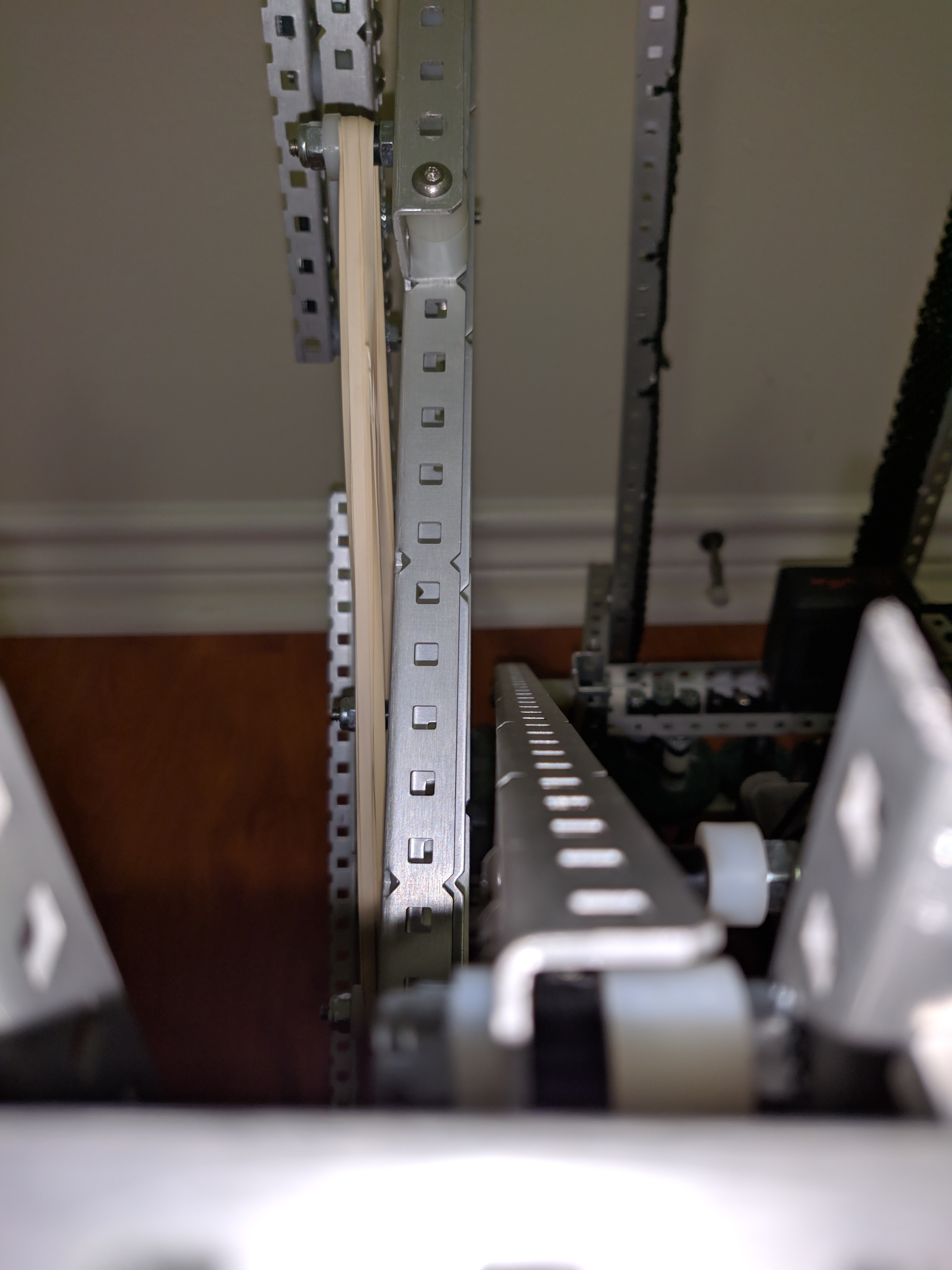

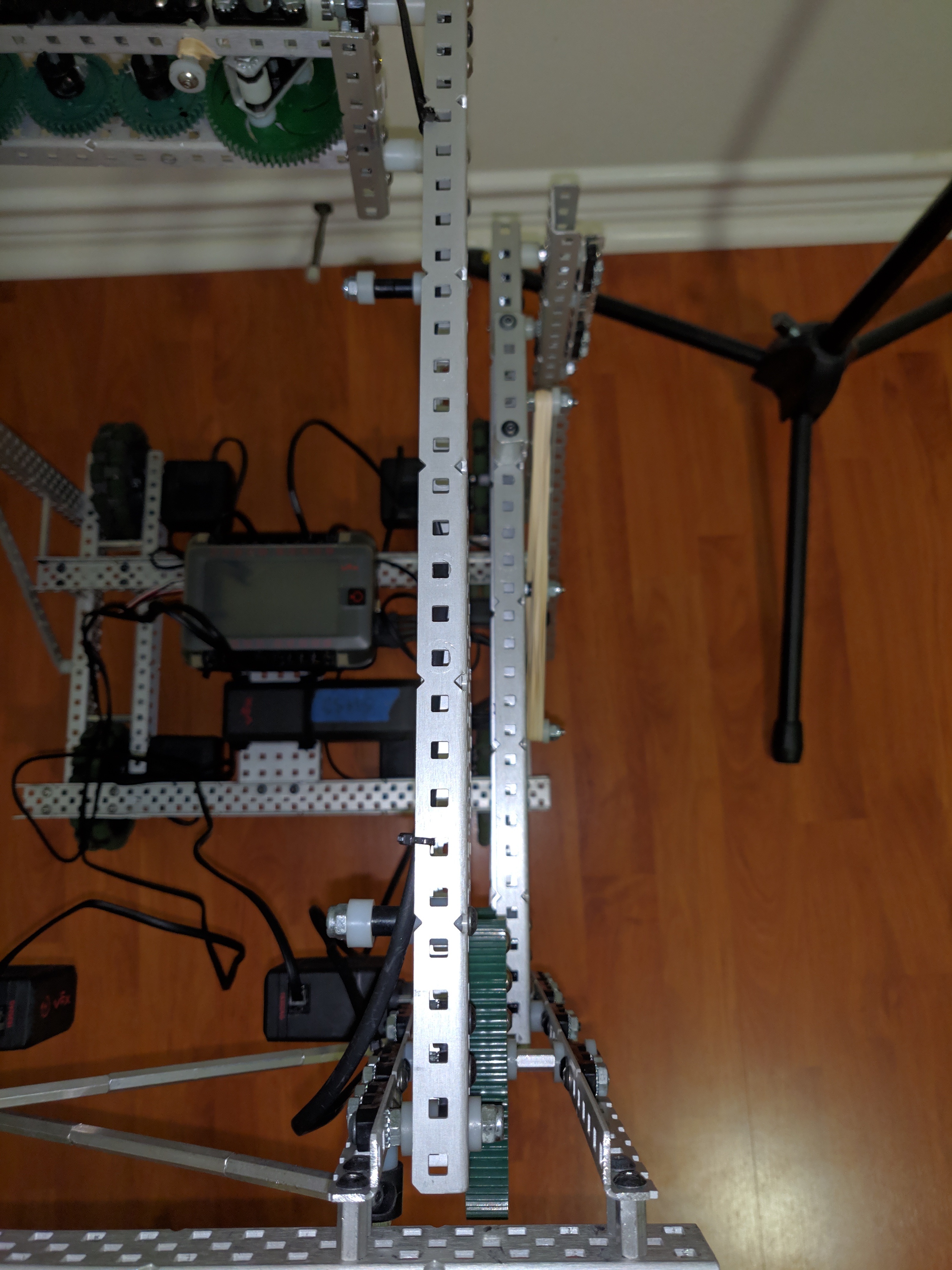

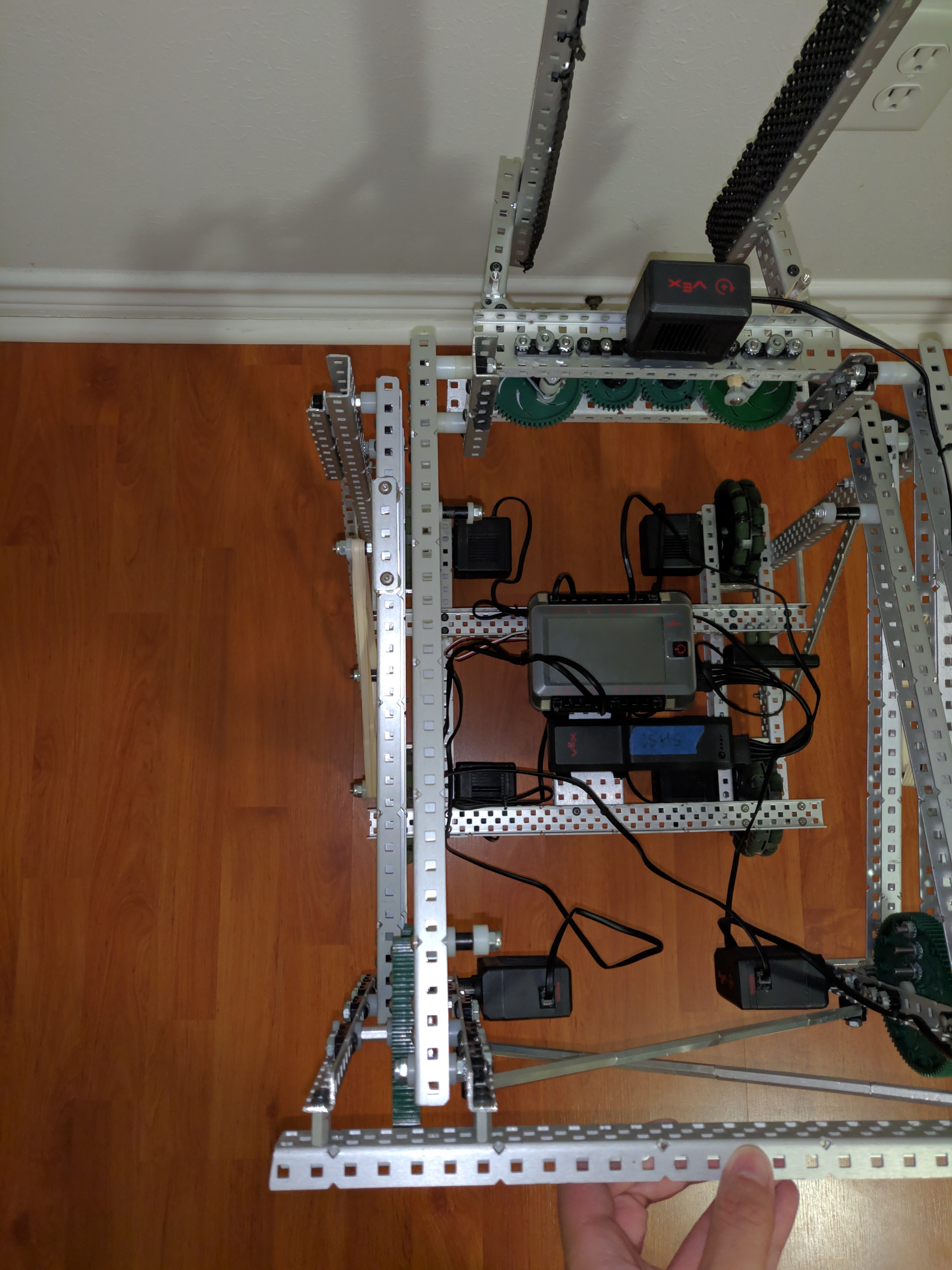

Okay first off I just want to say thanks for the screw+standoff idea and using the kep nut to keep the screw straight because those really helped lessen the slop in our DR4B. Now the only problem we have is our 4 bars are too close to each other so now they hit each other when we go up and down. We’re hoping that putting a brace across the bottom 4 bar will help with that though.
Do you mean the two linkages on each half of the lift are hitting each other or the two halves of the lift are hitting each other?
Um I think I mean the two linkages on each half of the lift are hitting each other. I can send a picture of it to make sure we’re talking about the same thing?
Also since they’re too close I can’t put rubber bands on both sides of the lift arms rip.
I think a picture would be very helpful.
Here are the pictures of the area in between the two 4 bars. Not much space in between them…
It looks like the screws are the only things that are touching the other bar, and you can file that area slightly.
Yeah normally they don’t touch but when we go up and down the DR4B will sway side to side and clip the left side. We’re hoping that bracing the top and bottom will alleviate that though.
Bracing it should fix the problem. You also might want to try tightening the joints slightly so it doesn’t wobble as much.
Yep bracing the bottom and top 4 bars really helped and now it goes up and down pretty smoothly. Thanks for all the help!
No problem! Let me know if you have any other problems with it.
