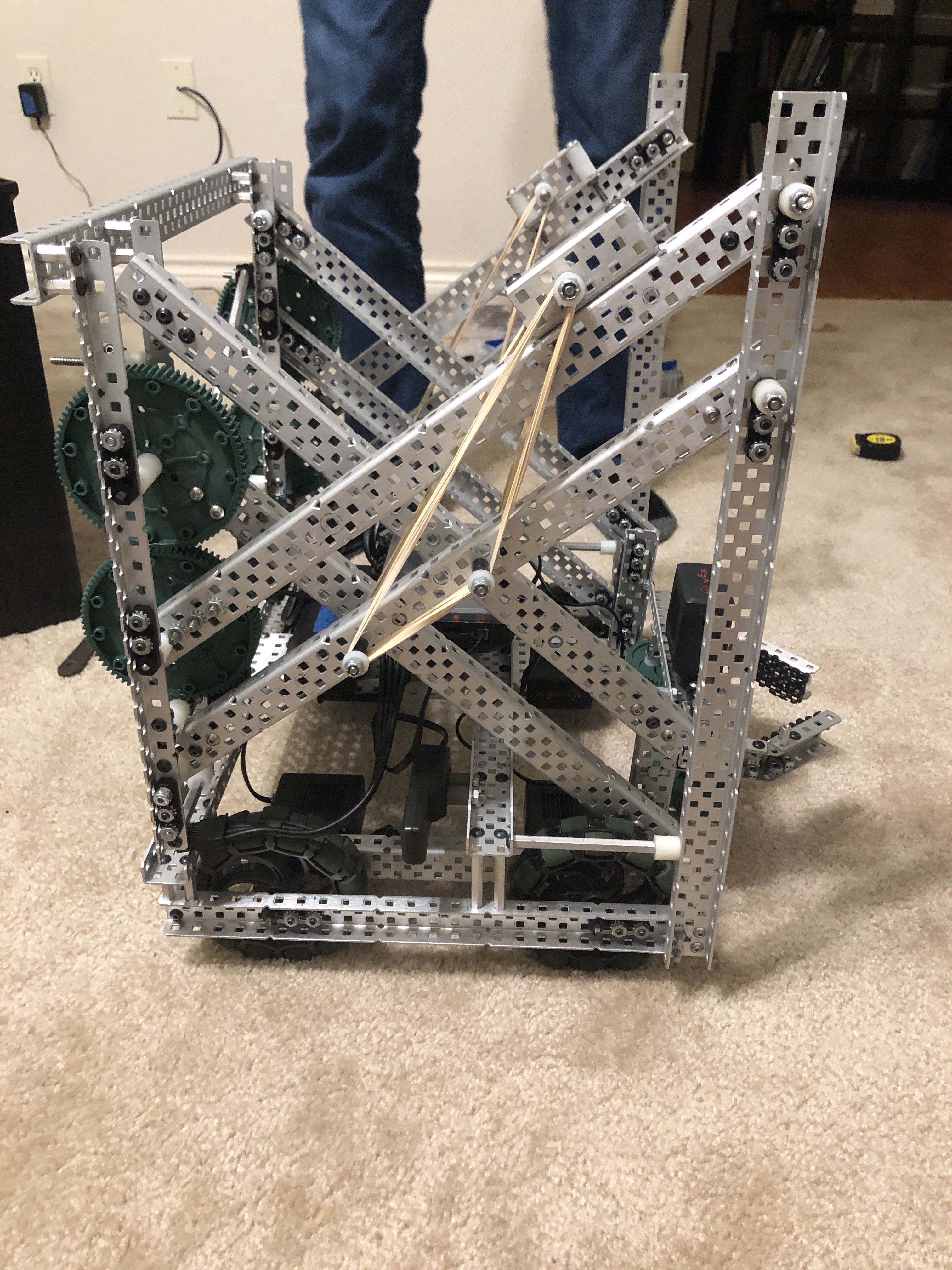

Here are some pictures of our robot. With the DR4B in the stored position, do you think we’ll be able to fit a functioning x brace on the bottom?
If you look at some past smaller dr4b designs you can get a pretty good feel for how to brace the bottom bars. The two main ways that i have seen are having a c channel across perpendicular with 2 bars coming off of it to create triangles or a big X made with 2 c channels or standoffs.
Ill link a few examples of these types of bracing:
you should be able to incoorperate somthing similar to one of these into your robot pretty easily.

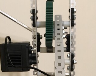

That’s true. By the way, do any of y’all know how to fix gears that warp on the DR4B? It’s mainly our high strength 84 tooth gears.
What do you mean warping? Are they literally bending? Can you post a picture?
I could be wrong, but it appears you have your gears rotating around shafts. The problem with shafts is they are not very sturdy and can wobble around a lot even through bearings, which could be why it looks like your gears are bending slightly. Instead of using shafts, use a screw that is locked to the mid-section with a keps nut, and plastic inserts for your gears. If your mid-section is 6+ holes wide (which it appears to be), you will find that Vex doesn’t make screws long enough to go through both structural bars. Use a nylock and a teflon washer to keep the gear in place, leaving some length of screw sticking out. Don’t tighten the nylock too much or you will create unnecessary friction. Use a standoff to connect the remaining length of the screw to the other side of the mid-section so that it won’t be able to bend. That should eliminate any problems you experience with the gears.

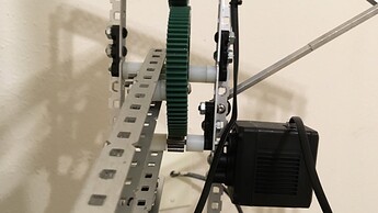

Here are some pictures:
They don’t show it that well but the actual gears themselves are bending which is a slight problem.

Make sure your spacing is as tight as possible without making metal rub against metal. Also I see that there is a small amount of space between your gears and the lifting bars as opposed to having the lifting bars resting right against the gear. Get the gear as close as you can to the lifting bars for a little extra support.
Surprisingly your shafts have not bent yet, but with a length like that you would definitely experience this in the future. Last year in TP we managed to get fit two lifting bars with gears in a 4 hole wide space and still had problems with shafts bending. You could either replace the shafts with HS shafts to prevent this even further, or do something like 1814D did in TP with their cap bot.

It might just be the angle, but it looks like the two towers at not the same distance apart at the bottom and top. This would make it less stable, and it would cause the gap between the gear and spacer in the second picture to occur. Hope this helps!
Uh that would suck if it’s actually different because both towers are spaced the same. I hope the c-channels aren’t bending.
