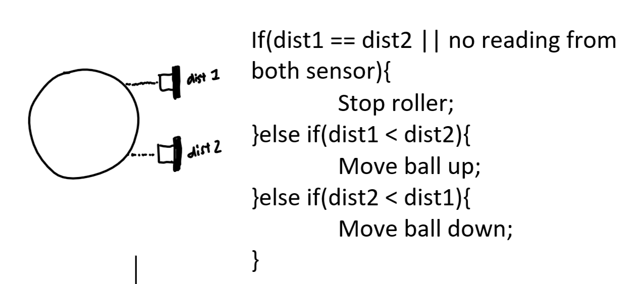

You can try moving the optical sensor downward to account for the overshoot due to the refresh rate, or simply just reduce the roller speed so it’s less likely to overshoot. Another method can be using 2 distance sensors, and use them to control the roller until they get equal readings (ball in the center) to have accurate indexing. See illustration below
I think there was a miss understanding with my explanation the optical sensor is being used to detect the white lines on the field not the balls as they come into the robot. We are not using the distance sensors for it it we are using the optical sensor.
