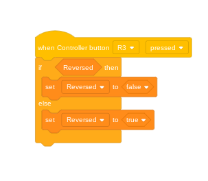

Define a variable:
drive_mode=0/1
change drive mode with a button press

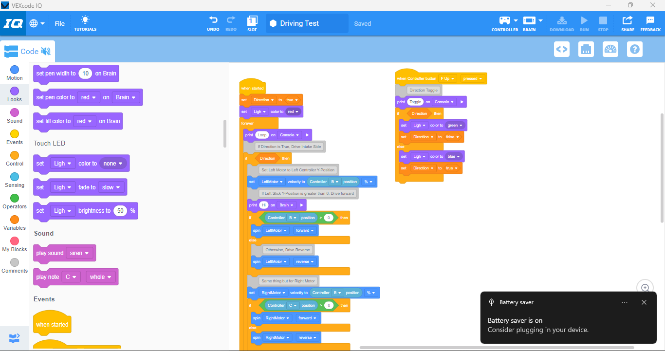

Thanks for the response. We use VEXcode IQ Blocks. Does your suggestion work for that programming language?
Yes, exactly. Any suggestion? We use VEXcode IQ Blocks.
Yes. However, you can use ‘shift’ keys. Where you hold a button down and the actions of other buttons are shifted to new actions.
Because it’s easy, we program the driver controls with the default ‘tank mode’ drive train. Could a ‘shift button’ work with that? Or would the shift only work if we manually program the drive controls?
Seems honestly inconvenient to drive and hold a button, our team has it binded to a button that toggles drive modes.

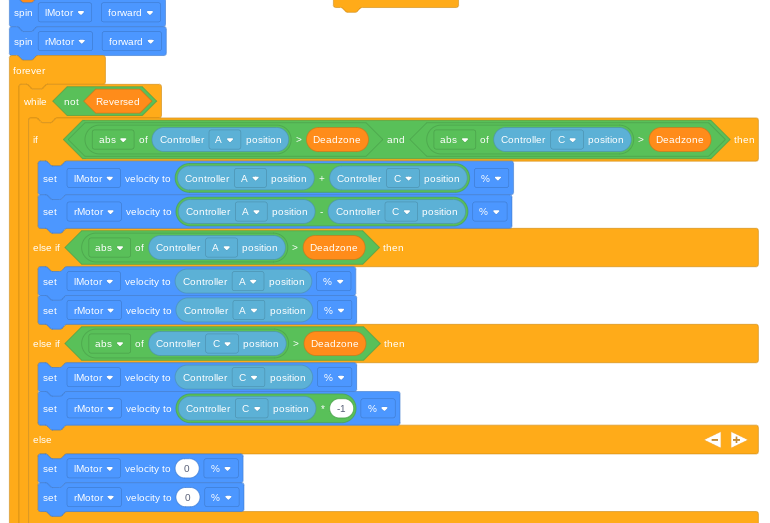

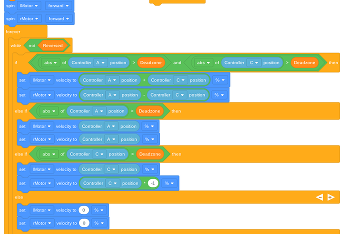

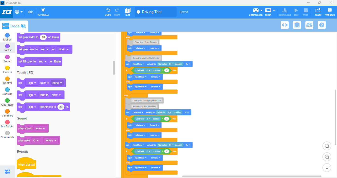

I havn’t tested this on a robot yet, and it is a bit convoluted, but I might be able to give you the gist
You could actually make it simpler by setting velocity, example bellow.
Blocks
Screenshot 2022-12-12 11.14.21 AM
Python (The formatting is weird I apologise I have it in something)
    lMotor.spin(FORWARD)
    rMotor.spin(FORWARD)
    while True:
        while not Reversed:
            if math.fabs(controller.axisA.position()) > Deadzone and math.fabs(controller.axisC.position()) > Deadzone:
                lMotor.set_velocity((controller.axisA.position() + controller.axisC.position()), PERCENT)
                rMotor.set_velocity((controller.axisA.position() - controller.axisC.position()), PERCENT)
            elif math.fabs(controller.axisA.position()) > Deadzone:
                lMotor.set_velocity(controller.axisA.position(), PERCENT)
                rMotor.set_velocity(controller.axisA.position(), PERCENT)
            elif math.fabs(controller.axisC.position()) > Deadzone:
                lMotor.set_velocity(controller.axisC.position(), PERCENT)
                rMotor.set_velocity((controller.axisC.position() * -1), PERCENT)
            else:
                lMotor.set_velocity(0, PERCENT)
                rMotor.set_velocity(0, PERCENT)

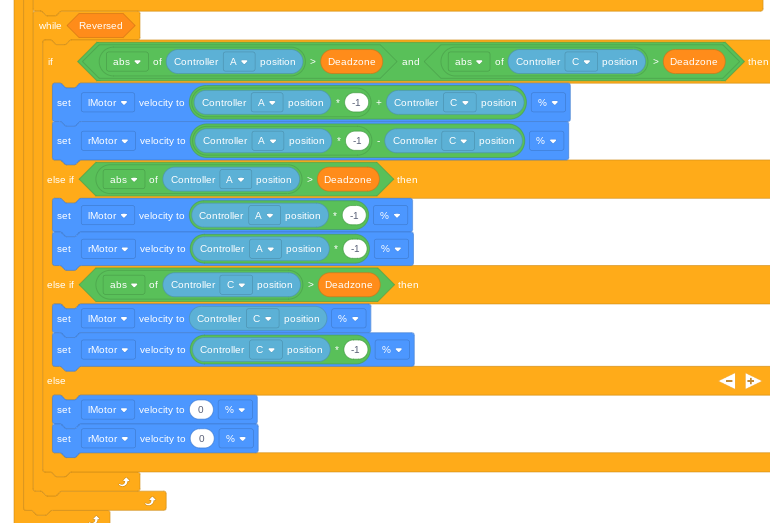

            while Reversed:
                    lMotor.set_velocity((controller.axisA.position() * -1 + controller.axisC.position()), PERCENT)
                    rMotor.set_velocity((controller.axisA.position() * -1 - controller.axisC.position()), PERCENT)
                    lMotor.set_velocity((controller.axisA.position() * -1), PERCENT)
                    rMotor.set_velocity((controller.axisA.position() * -1), PERCENT)
                else:
                wait(20, MSEC)
            wait(20, MSEC)
        wait(20, MSEC)
If you have any questions feel free to ask!
