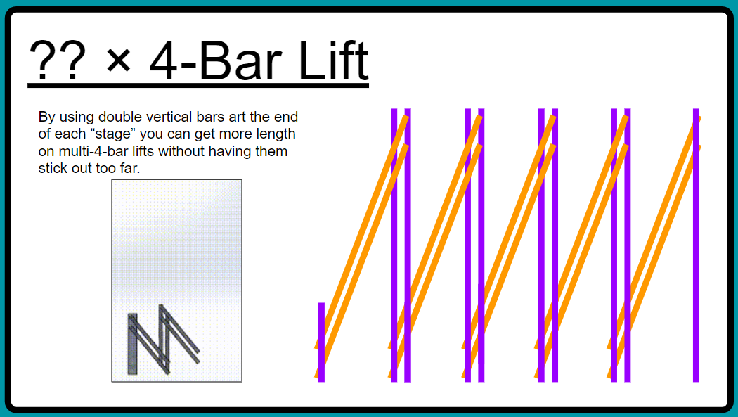

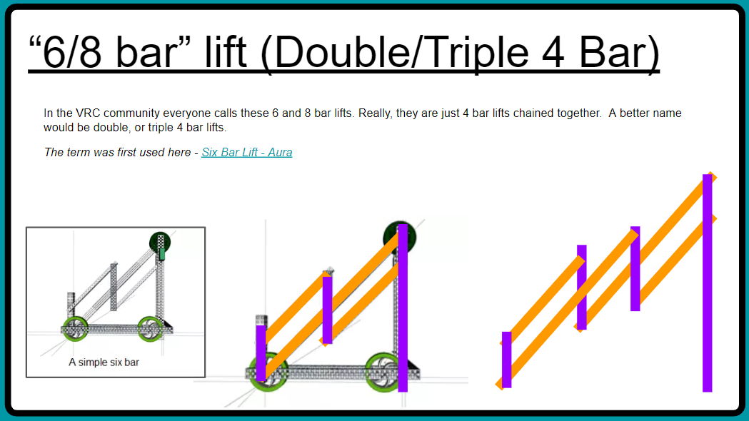

6 bar is just a vex-ism. It would be more properly called a double-4 bar, and an “8 bar lift” would be a triple 4 bar. Origin of the six bar lift term/design?
