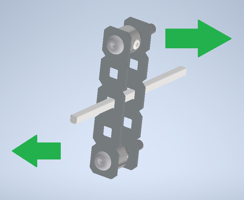

I have been working on a design and it needs a reversal on the monition of the pneumatic piston. If the piston is out, I need to have have a way of converting that motion backwards as simple as possible. Same thing if the piston is retracted, I need to have to motion going forward.
Essentially, I was wondering if anyone knew of a relatively simple mechanism to make a standoff l move in the opposite direction of where the piston is moving.

While the proper-terminology speech from kmmohn was appreciated, it did little to answer the OP’s question. One way to do so would be through the use of gears and racks. Racks are the linear gears. Below is a screenshot of what I mean.
One of the racks could have a pneumatic cylinder, whereas the other could have the standoff.

You could build a lever with Reverse motion linkage as another option.
Gears and linkages are both great ways to do this. I want to know why the OP wants this. Is it because they think they need to start retracted for example? Is the true problem wanting to invert the direction of motion?
I need to start extended and then retract to close a claw. I also need to be able to open and close it as needed. The claw just has to have the Air Cylinder starting extended and have the claw close when it is retracted.
If you have double-acting cylinders, you can start with the cylinder either extended or retracted: just swap the air lines. Double-acting cylinders are always pressurized during operation.
