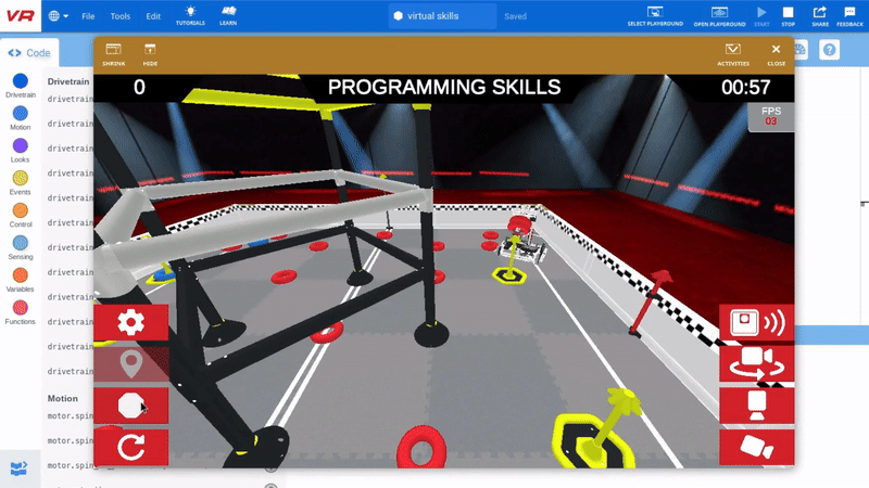

I was working on virtual skills when a ring that was in front of the arm teleported onto it. I was using duckduckgo on windows 11, although the settings screen said windows 10. the code that triggered it up to the glitch happening is shown below.

After further testing, I found that it takes a few runs before it works, and that it also happens in Microsoft Edge on the same computer and on a school chromebook. here’s what it looks like when it happens:
glitch
