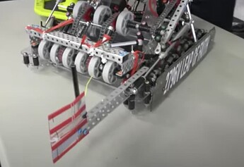

Many use a doinker mech, a pneumatic, sometimes motor powered bar at the front with a bit at the end which can be also be used to grab, move and flip mobile goals. They usually put an extra part (like polycarbonate for example) on the top so that they can move rings more efficiently.
Usually called a “doinker” mech, its a horizontal expansion (usually pneumatic powered) that flips out to the front.
(Image credits to FUN Robotics and 2796V)

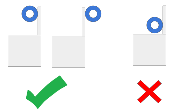

Legality is a bit iffy here, but here is a rough explanation:
(Assuming the doinker mech is straight and not concave, and the robot is possessing 2 rings in their intake)
The two left cases are legal, since the robot is manipulating the objects with a flat, non-concave surface of the robot (and hence would be plowing). However, as soon as the ring slides into that “pocket”, the robot is using a concave/more than 2 sides to manipulate the objects, which would not be plowing (and hence would be possession and illegal).

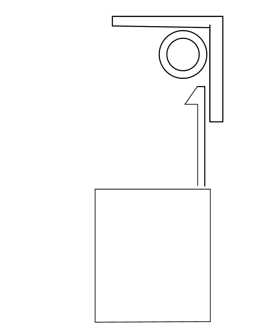

Thank you for the diagram, what I can do to keep it from coming in contact with the bot and being considered concave is this design I have made with a wedge that when driven forwards should be able to hit the rings out of the corner.

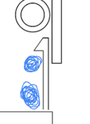

The two areas highlighted in blue would be considered concave. So if the rings go into there, that would be considered possession.
However, depending on how big the wedge is, the top blue area might not be considered possession by the head refs (if it’s really small it may be negligible, but this is up to the head ref).

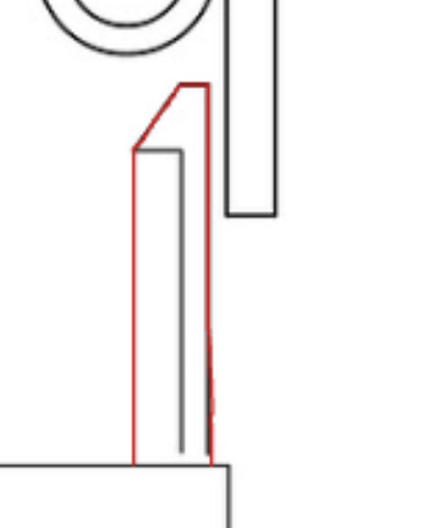

Just to be safe, I would either make the wedge’s horizontal profile really small, or make your doinker mech shaped like the red outline below:
The manipulator in my design wont be swinging but instead when it hits the stack going fast(drivetrain) it will launch it to the side. But I should definitely fill in the red area like you said.
