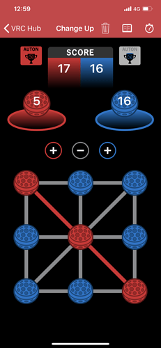

The cage is truly an OP strategy for this game, seeing that scoring 1 diagonal and winning autonomous can grant you a guaranteed win.
If you win auton, score 3 balls in the center and cage it, and defend the other 2 goals (seeing that u have 2 bots for 2 goals, it should be easy), you will guarantee a win.
I can see some worlds level autonomous consisting a hood which go for the WP and a bot like this that score 3 balls and pre-cage center, releasing it immediately after auton
Still don’t think this is a guarantee-win strategy.
A 4 bar and chain bar of equivalent lengths will take the same arcs to reach the same points
Win auton, 3 balls in center and 1 ball on each of the other corner, owning the goal. The opponent will still score less even if they have scored all of their balls
you misunderstood my point.
What i mean is that this caging method is not unstoppable. It will only work if the opponents allow you to own the centre goal.
so a lot depends on the fight for the centre goal.
You are assuming that the team WILL own the centre goal. But it is not a given… especially if the opponents know that it will be caged, you can be assured that there will be (robots’) bloodshed over it.
