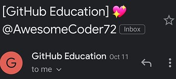

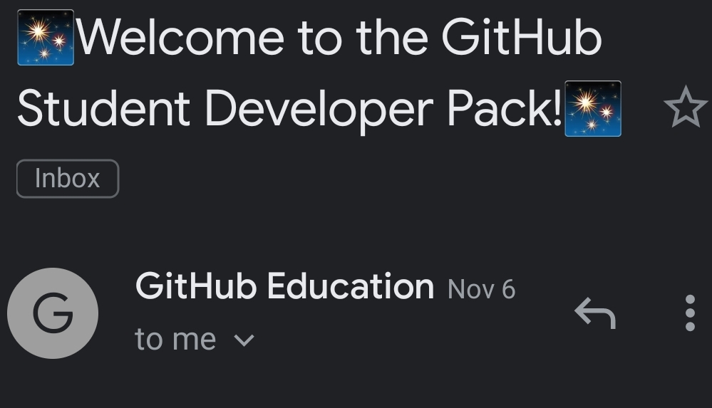

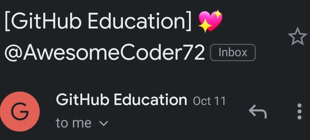

I needed to sign up for github education to use gitkraken.
Summary
IT TOOK A WHOLE MONTH
