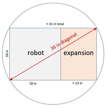

I have not seen this posted yet, but be careful how you interpret the expansion limit.
As it is written, a full size robot cannot expand out a full 18" as some horizontal dimension would now exceed 36". The rule specifically uses the language “no horizontal dimension may exceed 36.” It does not make the legal size a rectangular 36"x18"x18" volume.
Maybe this will help visualize it.
This post seems to be the definitive explanation on the matter.
That does indeed seem to cover it. I added the circle to my diagram at the last second and didn’t think it through enough… good catch.
