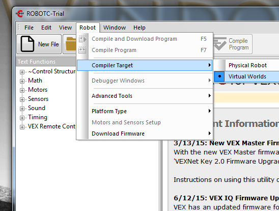

I just installed RobotC virtual worlds, 4.56 release, I want to explore using a virtual robot but in the robot menu in the “Compiler Target” I just see the option of Physical robot. I saw previous releases had the “Virtual worlds” option but I don’t see it.
I’ve tried to set the menu level to “Expert” or “Super user” and the only other option I get is the “PC Emulator” but not the virtual worlds.
Has this been deprecated?

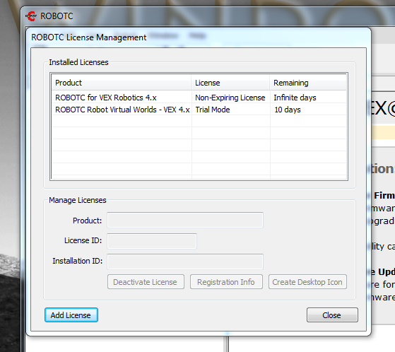

ok, so you need to start the trial.

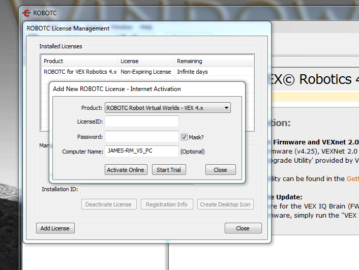

go to “Manage Licenses”
click add license
select RVW for VEX
click start trial
Now you should be able to select virtual worlds
