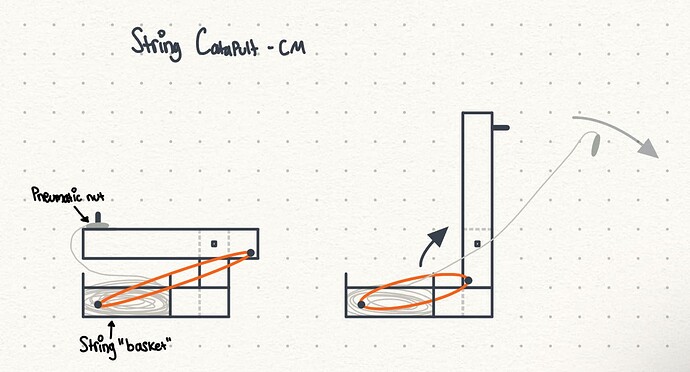

Diagrams are great for prototypes and potential ideas. When you are documenting any brainstorming processes in your notebook, having diagrams to allow the judges to picture what you are talking about is great!
Once an idea gets more concrete (designed in CAD, small scale model built, mechanism constructed, etc.) its nice to include photos/screenshots too. This doesn’t mean diagrames are only for brainstorming, rather that at this state it would be helpful to also see how said mechanism will fit on your robot.
As far as charts go, I recommend using decision matrices for all major brainstorming processes (deciding the initial robot design, changing to a different shooter type, etc.), and pros/cons charts for less important ones (lift motor overheats too often, last part of programming skills run is not 100% accurate, etc.). Charts are great for any time you are testing something, whether it be an autonomous run, a subsystem on your robot, or a change made to a particular mechanism. This will allow judges to see that you are understanding and properly interpreting your testing data and using it to guide your design decisions, Note that these are just recommendations, and that every team dos things differently (in fact, the judge’s guide does not mention an “end all be all” way for proper problem solving documentation, but that the engineering notebook rubric should set the bounds for how you document it).
Here is an example from my team’s engineering notebook this season:
