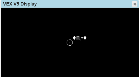

Recently, I have been experimenting using sensors in RobotMesh studio in Python, but when I tried to print the word “test”, it came out in wingdings font for some reason.
Result:
Code:
I don’t know what’s wrong and I haven’t found any way to change the font in the API reference.
Ideas?

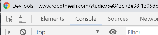

On a project showing the error, please open the Chrome developer tools by pressing F12 or Ctrl+Shift+I, and screenshot the “Console” tab, shown here:

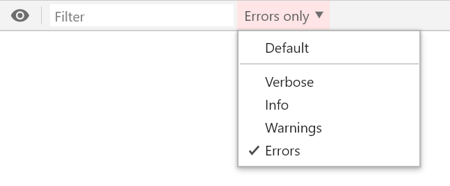

Sorry, in the filter dropdown, select only Errors, like so:

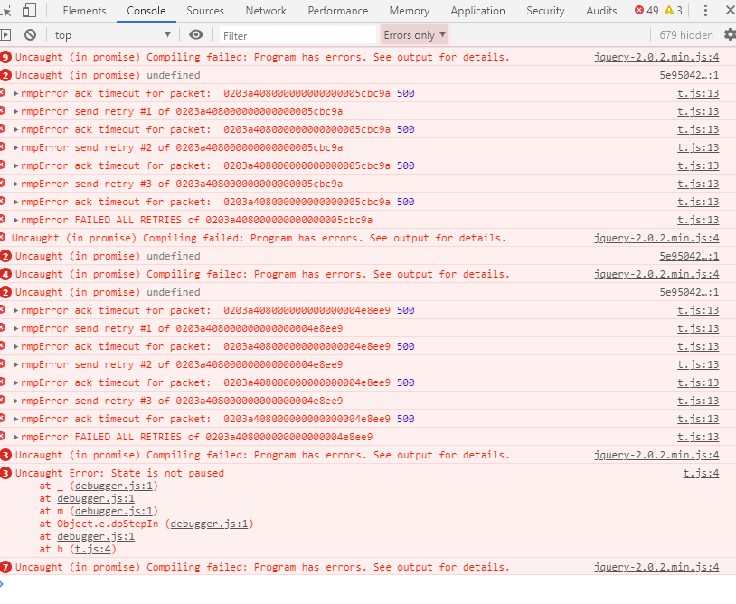

If you refresh the tab and then run the program again does the Wingding text stop appearing? If the text is still there after refreshing, are there red errors in the dev tools console?
It does disappear. Any idea what could cause that? It seems so odd that the program is even capable of printing in wingdings
One of these undefined uncaught errors, I am guessing, knocked over some critical piece of RMS. Once that happens, you can see odd things. The characters look like typical Unicode junk, like if random data was written to a buffer instead of the string you wanted.
