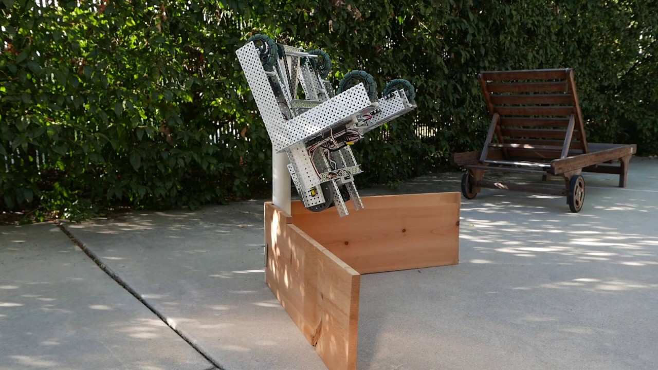

One I did a few years back, obviously for a different game so not directly applicable, but same idea.

over center has nothing to do with attaching to top of bar, as long as the robot COG is above the mechanism holding it up, it should be ok.
Proof of concept, imagine that the robot rotates about the point where the masking tape is, if the COG is over the arm resting on it, should be fine. Note the POC does not have an active mechanism holding onto the vertical bar.
Okay so just as long as the weight is balanced correctly on the arm it doesn’t matter where it grabs the pole
