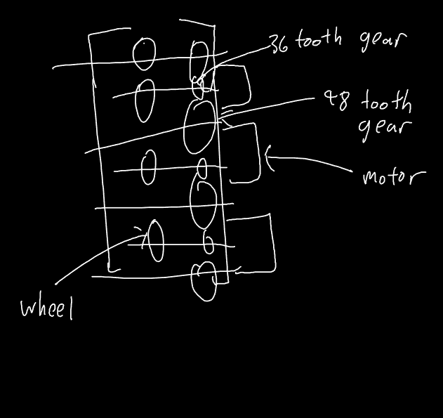

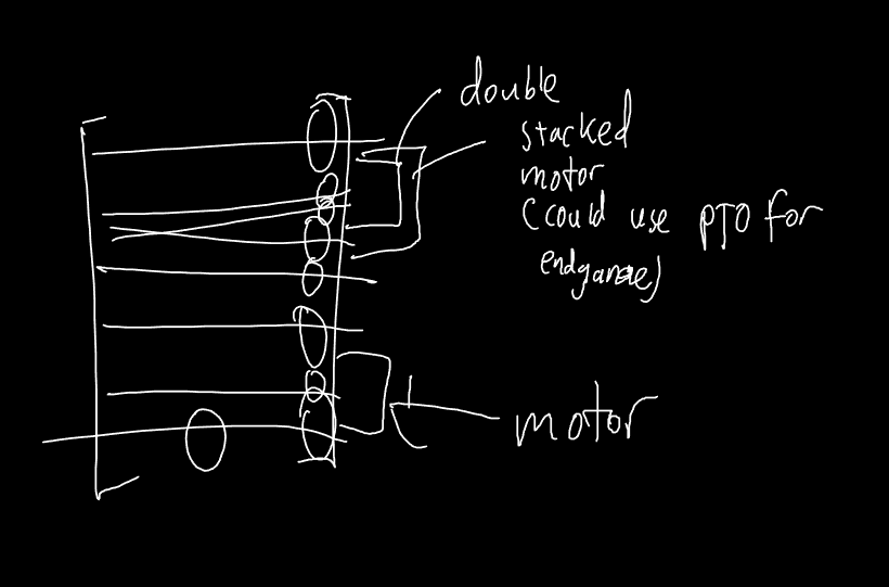

you could do a 36 to 48 gear drivetrain to achieve a 450 RPM drivetrain which is fast and gives you control over your movements. You could put your motors side by side to even out the weight, or if your robot has more weight in a certain position you could opt to do 2 stacked motors and the other motor next to the stacked.
The image above is for the 6 motor even drive with 3:4 gear ratio
The sketch above is for stacked motors. The top motor could be used to PTO to endgame if you want. (Although 4 piston should be enough for most cases.)
Also, do not question my drawing abilites.
Yeah, our team also uses 450 rpm with 36/48 gear ratio on blue motors. This gear ratio is pretty good as it is a good balance between torque and speed. On our last bot, we had a direct 600 rpm drive although i wouldn’t recommend using it, as when we were pushing other bots they had more pushing power. So to answer @TibTy question, i would recommend a 36/48 gear ratio with 6 motors.

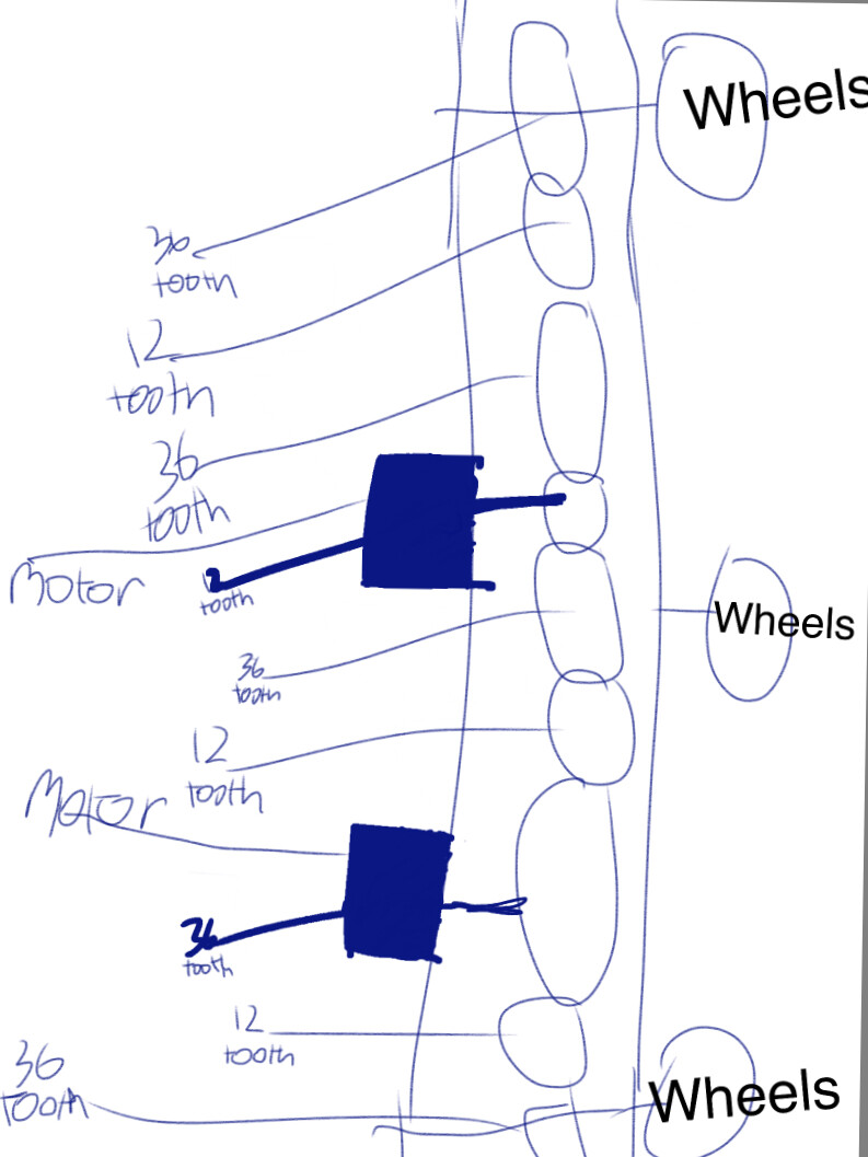

My Team uses a 36 tooth 12 tooth ratio that looks like this
