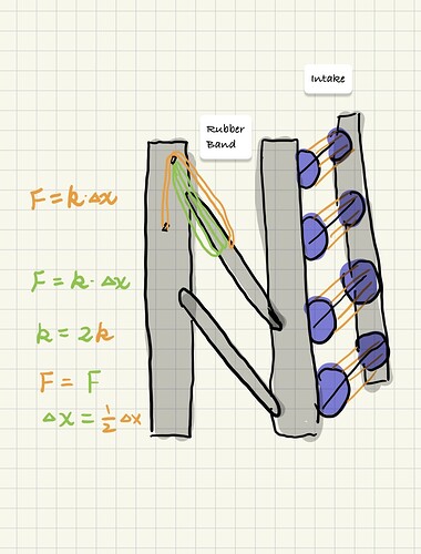

Hello everyone, our team is currently facing an issue with the elasticity of the rubber band we are using to hold the intake frame with rollers for the purpose of intaking purple blocks. The height of the intake is critical for our robot, as even a slight decrease of 1 inch can make it difficult for the purple blocks to reach the elevator where they are stored. Despite releasing the rubber band when not using , it quickly loses its elasticity after only 6 rounds in the competition. We are seeking advice on how to effectively address this problem, as switching to a new rubber band during competition may result in it being too tight, and fine-tuning its position will require significant time and effort. Any suggestions would be greatly appreciated.

You might want to try the 117B bands for the front. You will need to do the loop and twist double / triple to make them the right size. What you end up with is a multi strand rubber band, this spreads the tension across the strands. It may help your wear issue.
Thank you . You are right. I just arrived at the same conclusion by applying Hook’s law. Connecting the rubber bands in parallel will result in less variation in length due to wear. Our team currently uses the wrapping method depicted in my picture and sketch (orange color). However, if we were to follow your suggestion (green color), the k value would double and the length change would be halved under the same force of gravity, F.
Please make sure that that this and the picture makes it into your notebook! Judges like this science stuff!
