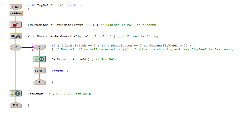

My students have a similar design. We have a top belt that feeds the flywheel and a bottom belt that feeds the top belt. This way we can have a ball in queue while we are loading additional balls. Here is a screenshot of the top belt function.
[attachment:56674071f24ad][attachment:56674071f24ad][attachment:56674071f24ad]
Ok, we will try something similar and report back. Thanks again!
