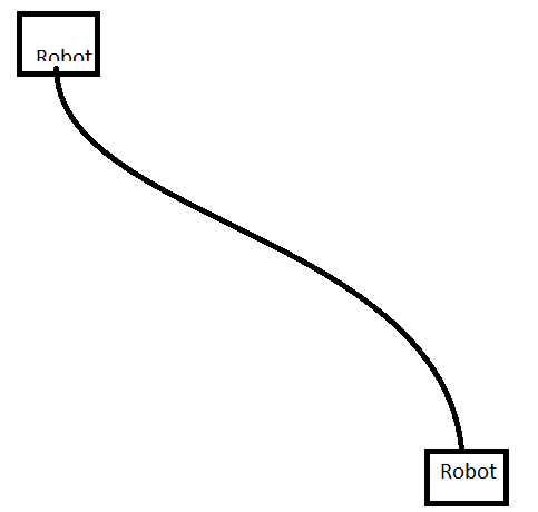

In my autonomous research, I heard several people mention “S Curves.” Essentially, the robot follows the pictured path in one fluid motion. Invictus (365X) used these in their 1st place skills run. From what I can tell, “S Curves” allow teams to quickly move to different positions in auton. How do you program an “S Curve?” And what makes an “S Curve” more accurate than linear motion?
S_Curve
So these S-Curves are Bezier Curves/Spines from 2-D motion profiling. Bezier curves are based on Bernstein polynomial extrapolations. Splines are more accurate since 2D motion profiling takes into account the motor’s 3rd derivative of position, and the polynomials account for the variance in inconsistencies present.
http://www2.informatik.uni-freiburg.de/~lau/students/Sprunk2008.pdf
You could accomplish this through the okapi library in pros. They have s-curve math planned out for you and all you need to do is a generate a path (and configure your robot).

It is definitely possible to implement S-curves in any programming system. (We implemented something similar on the old system in RobotC). What’s different about using PROS is that it includes a library called OkapiLib, which provides implementations of S-curves and various other forms of autonomous movement for you.
Your options are effectively:
  • Switch to PROS and use functionality from OkapiLib
  • Implement whatever autonomous motion you want/need in VEXCode
  • Try to port OkapiLib (or something similar) to VEXCode
First one is definitely the easiest way to get from 0 to S-curves, but that doesn’t necessarily mean it’s the one you should do.

Additionally, s curves could be simplified into 3 motions if you aren’t at a level where you can comprehend the math behind that level of odometry: Wide turn left > Straight > Wide turn right.
A wide radius turn refers driving forward and turning simultaneously, so that drive train velocities L, R > 0 and R > L. This will result in an arc, and assuming you compensate for holonomic wheels drifting and variances in wheel speed. Just set the motor velocities so that one side is like twice the other, and then decide if you want to rotate until R.position is reached, or R.position-L.position is reached.
Then go straight and then repeat the previous procedure until the wheel positions are equal again.
>> Remember: The real odometry is way better than this. This method will not be nearly as consistent, and will not actually track the instantaneous position of the robot during the turns, and therefore will not necessarily end up where you want it.

Okapilib uses Pathfinder, which is open source on github.
