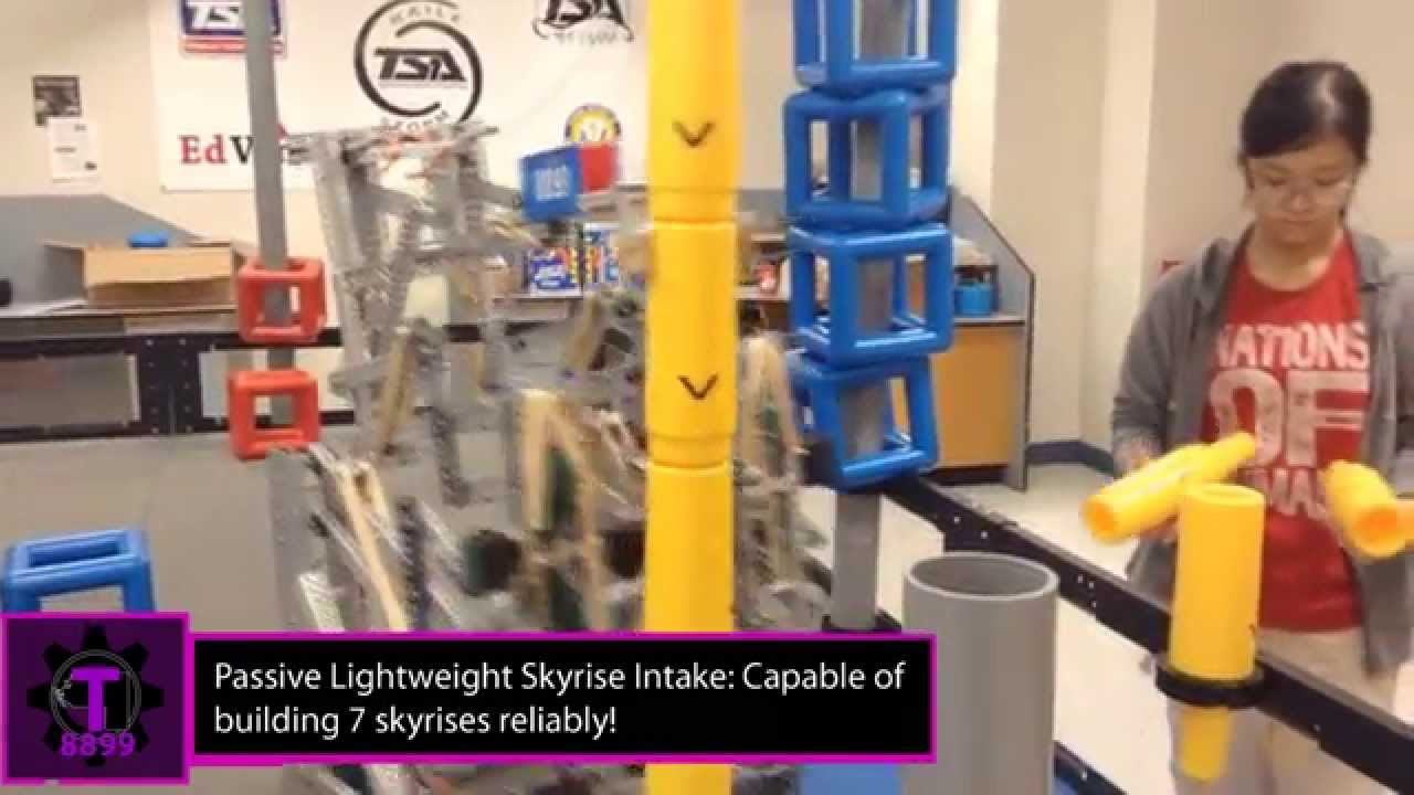

For anyone who did not catch our reveal video, here it is.
Our robot is mostly specialized in cube efficiency, but we do have skyrise building capabilities as well. Since our 2 cube intake is passive, this means that our robot is that much more reliable because there is no chance for an electrical failure happening to our needle. Both of our intakes are passive, and we’re using 8 motors total on our robot, 4 on the lift and 4 on the drivetrain.
Ideally, we would ally with a strong, reliable, and efficient Skyrise building robot, while we take care of the posts.
You can also check out our website for further details: [http://mcrc8899.org/
I also realized that we are the ONLY team from Florida in this division.
I Look forward to meeting you all in person!](http://mcrc8899.org/)
