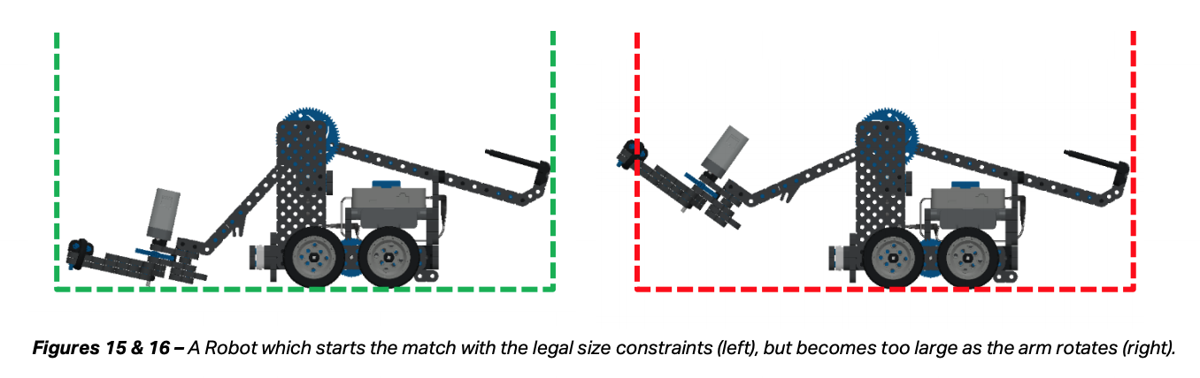

<R5> does not prohibit robots from being able to expand beyond the 11" x 20" constraint, only from actually expanding beyond the constraint. The note you quoted doesn’t mean that a robot whose appendages can extend outside the constraint is illegal, just that it’s possible for a robot to violate the constraint simply by moving an appendage. Take a look at the illustration that goes along with that note:
57%20PM
The robot on the left is legal even though it is physically capable of violating the 11" x 20" constraint; it only becomes illegal when it raises its appendage high enough to violate the constraint (as at right). So, it sounds like the robot you described is legal.
