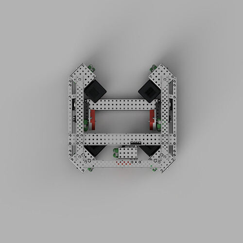

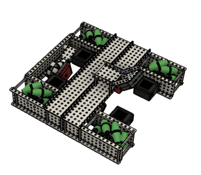

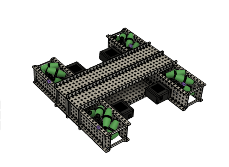

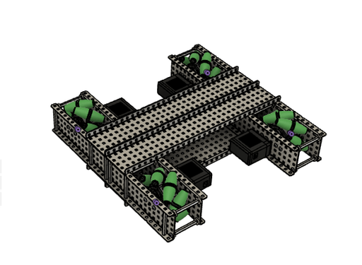

X-drive cad with tracking wheels
Sorry, those are the only renders I have.
That was part of the plan, tocmake the base compatible with mecanums and omnis, so it can be tank drive and a strafing one. I have also been trying to design an x-drive with lexan gussets, so that might work for another test base

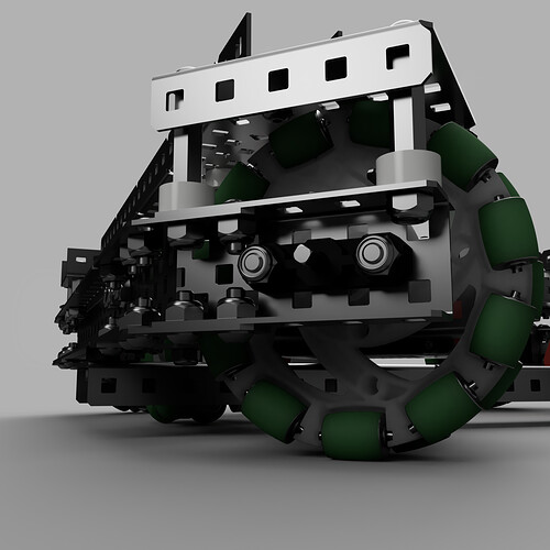

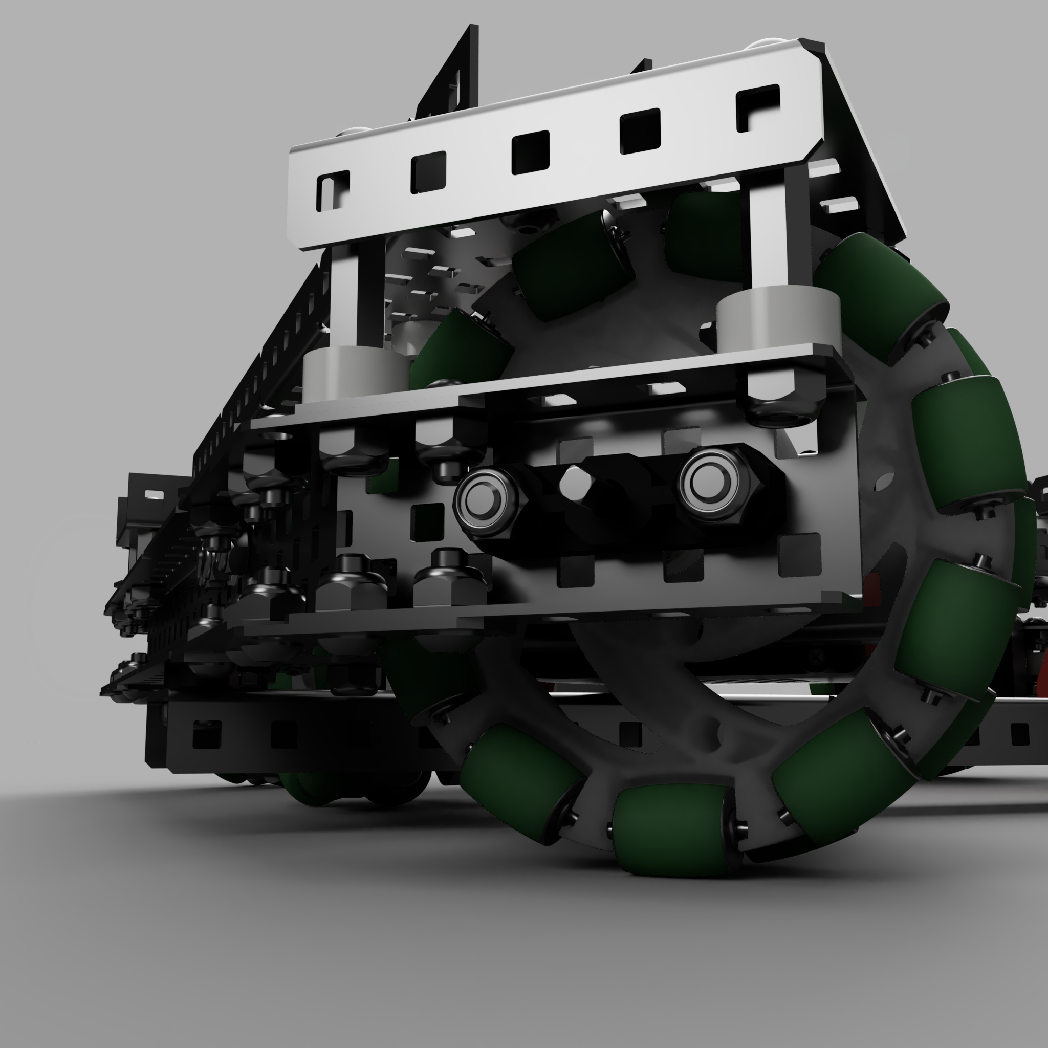

I have made progress:
So far I have:
  • Tracking wheels
  • Vision sensor set up to detect an object
    I plan on adding bumper switches in the back, and maybe ultrasonic sensors like @trontech569 said, sounds like a good Idea.
I think that v5 distance sensors work better than ultrasonic sensors. That’s just what I have heard, I have not actually used either of these.
Maybe tilt the vision sensor up a little bit more? I think that’s what that is at least
Yup, that’s what it is. It’s designed to pick up objects that would go in the empty space in the front, so I think the angle is good.
