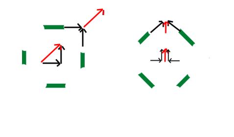

Ummmmmm Last time I checked Holos were slower than tanks due to canceling vectors…
You might want to check your math there…
  • Andrew
To be fair, that was what most of us said too. And then we proved it both theoretically and empirically that x-holo is FASTER in the “forwards” direction than a tank drive. TooMuchStrategy says watch the video - if necessary we might do a slightly more scientific version of the video with tape measures and timers etc.
I think that this actually works.
When I draw the vectors for both theories, the one on the right (where vectors cancel) seems to be incorrect.
Of course, if it’s been proven empirically, then our work is done here, isn’t it? Unless someone comes up with a weird exception that doesn’t make sense with our current model of understanding.

How would you calculate speed and torque if the offset is x degrees apart? I tried to figure this out but I don’t know enough about vectors.
I have a draft document on this that I’ll try to upload tonight. I’ll see if I can get our webmaster (bobsalive) to add it as a page on our website tomorrow.
If the offset is X degrees from the wheel being pointed straight ahead, the force component straight ahead is given by cos(X) times the force when X = 0. The maximum speed is given by 1/cos(X) = sec(X) times the maximum speed when X = 0. You can verify this result by multiplying the speed by the force:
cos(X) * 1/cos(X) = 1
which says that you are not losing any energy as you rotate the wheels. You are losing a lot of energy to friction as X → 90 degrees because the rollers are turning very fast.
Yes, dontworryaboutit is right (as usual). Here is an in depth explanation if you are interested: How_to_calculate_the_drive_ratio_of_an_X.pdf - Google Drive
The math checks out. An N-motor, Y-ratio “X” drive will move faster than an N-motor, Y-ratio tank drive. However, this is a little bit misleading. For a single speed system, you loose signifigant amounts of torque in the “X” drive. Therefore, the N-motor tank drive can be safely geared faster than the N-motor “X” drive, cancelling out the difference if we’re talking about two separate robots.
