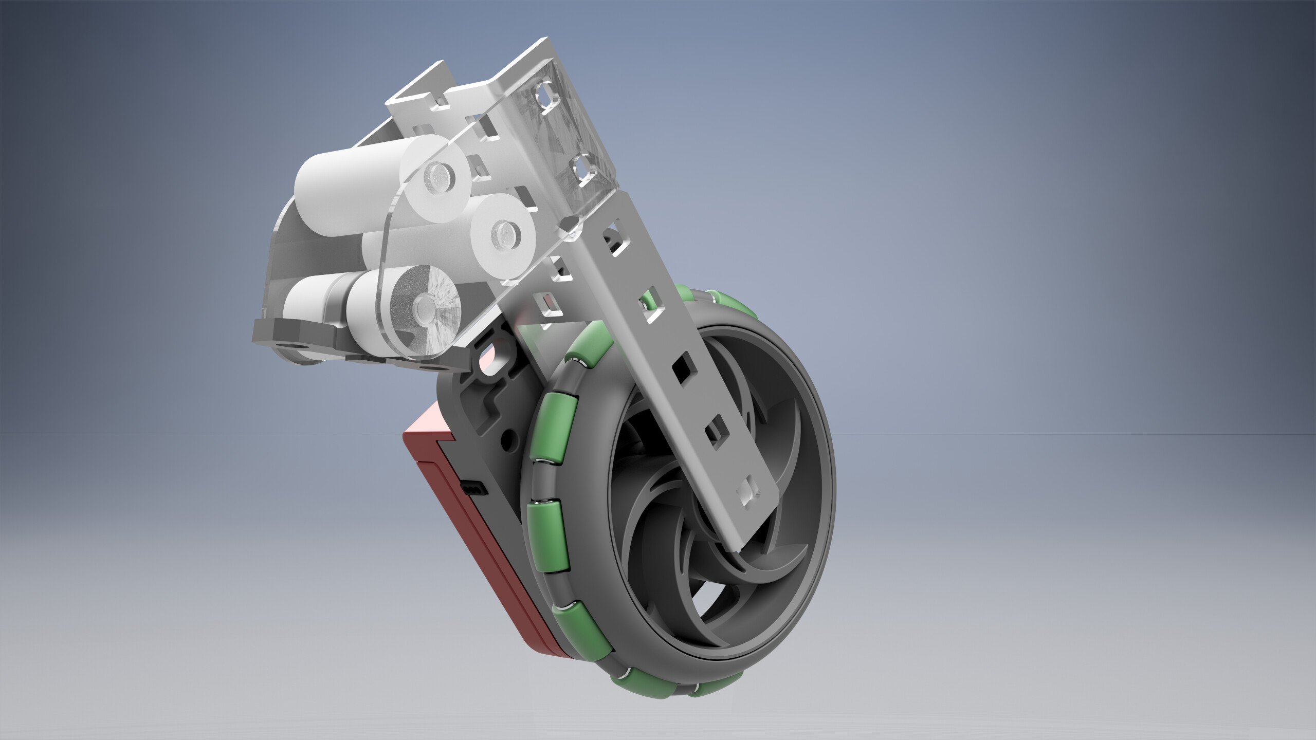

Tracker wheels
(Image courtesy of technik) Position Tracking Wheels Mechanism - #16 by technik3k
Tracker wheels independent of powered wheels are used commonplace as a way to track position in X and Y. 2 tracker wheels with encoders attached to the bottom of a robot can track a position of a robot as a
One question at this point might be, “well, why not just use the integrated motor encoders”? While this may work in an ideal world, there are still physical issues with this integration, as wheel slippage may cause inaccuracies with odometry which have lead teams to develop this method instead.
