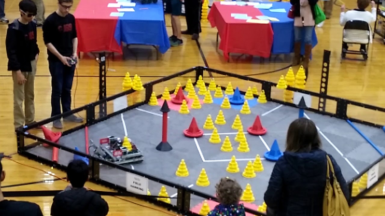

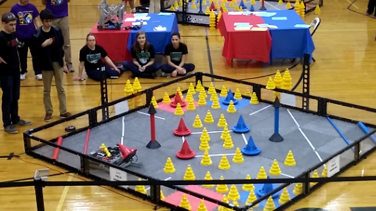

Here is a couple of interesting videos of 169A ITZ skills bot that had a pneumatic launcher:
I think, having something similar to pick up two mobile goals on both front and back of a TiP robot is perfectly doable. Then with a few extra cylinders you could lock the goals on each tray, making it impossible to steal them without damaging either the robot or the goal itself.
