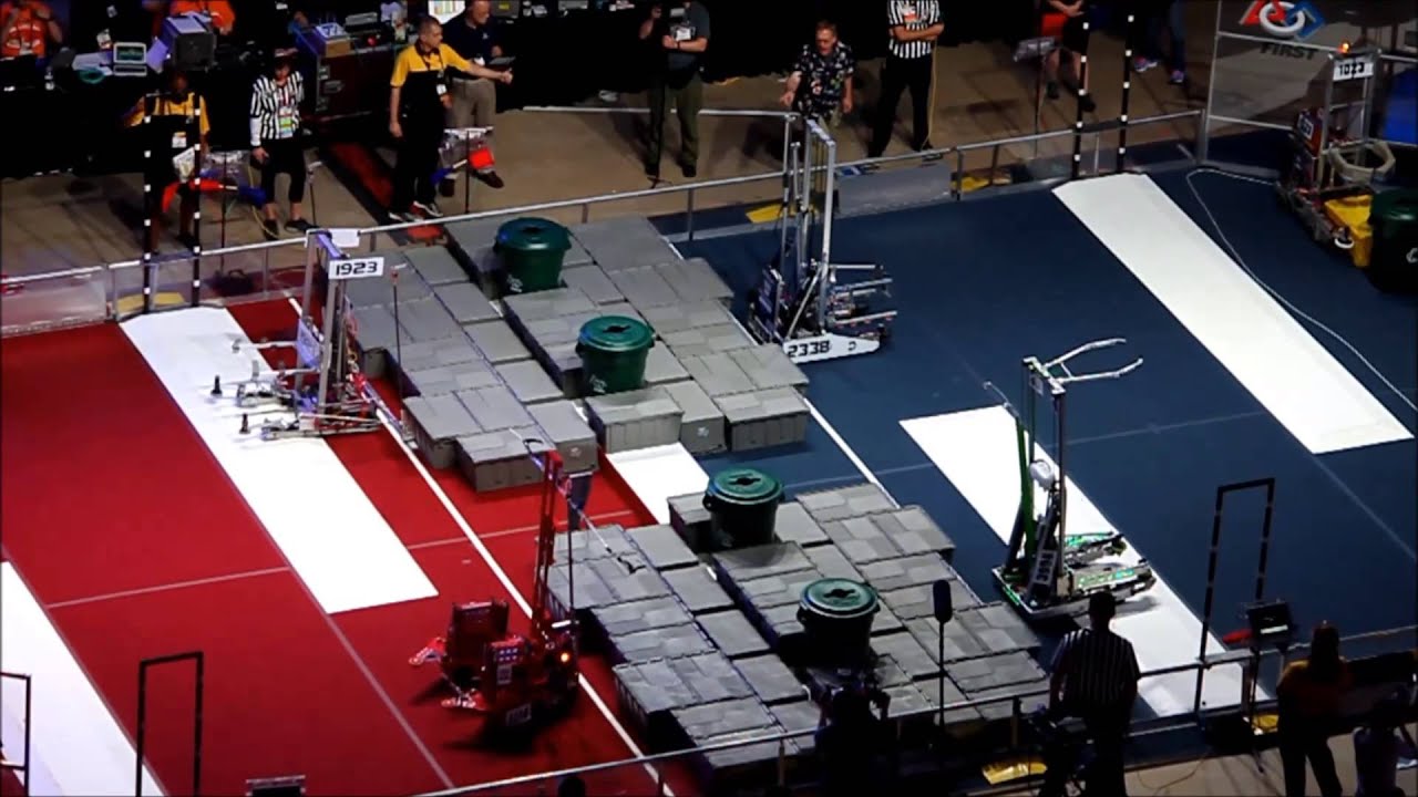

Reminds me of the FIRST game Recycle Rush. there was a row of trash cans on the dividing line and you wanted to capture them and drag them back to your side. Teams created these deployment systems that could go to the trash can in under a second, grapple on and pull it in the next second to keep the other team from hitting it. Awesome to watch, but then FRC fields have plexiglass to protect the drivers.
Ah, if only we didn’t have the 36” expansion limit…
