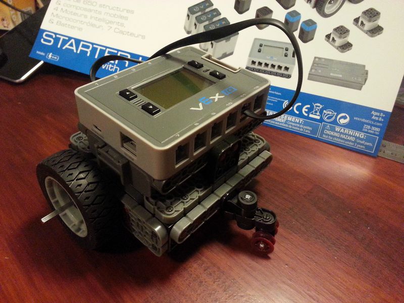

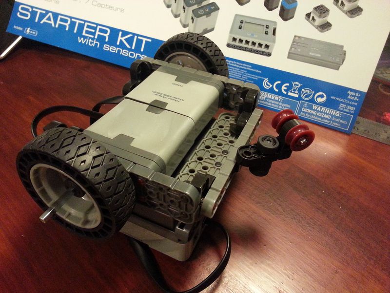

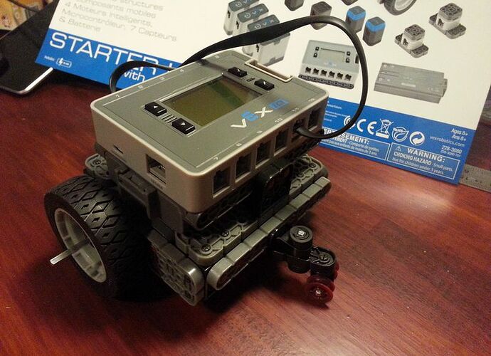

One thing I’m passionate about is quick and easy builds. While it is great to have some amazing creations to look up to, it is nice to have a simple base that is quick and easy to build. This is great in a classroom situation as well, allowing kids to get on to the programming more quickly. This base can be made with a single starter kit and has plenty of mounting points for sensors etc as needed.
I’m not a big fan of the 4 wheel skid-steering as it makes autonomous motion a little more unpredictable so I designed a simple castor wheel.
Would love any feedback

Simple and effective… but I guess that the castor wheel doesn’t behave very well when going backwards?
I was building something similar, but using the omni-wheel as a castor… just realised the omni-wheel is not in the base kit
The castor isn’t great, mainly because the axle bushing keep working their way up. I designed it with enough room to swivel all the way around so it can go backwards. I’ve rotated the brain 90 degrees and set it back a little to help with the balance, but it added 6 more pieces!
Nice simple build. I too wanted a castor. I came with a different solution myself albeit it is a little more complicated. I would love for there to be a “castor” part that takes the standard wheels so you can build something akin to ZTR lawnmower. With the skid steering it is impossible to build autonomous operation as you can never predict when the skid will happen. I like your simple castor design.
Got it… Didn’t understood the way it was built because my screen was too dark!
Having Omni Wheels on the front of the basic build reduces the skid in turning so that the robot is very responsive but still has traction going forward. Too bad that IQ doesn’t have the Mechanum (sp) wheels that are available in the regular VEX robotics. However, having a castor is something that I hadn’t thought of. Great idea!!
