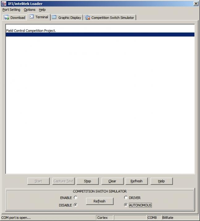

Here is some Code, I tried with the Competition Switch Simulator.
I might not have all the Modes Right, but it appears to work when the Cortex is First Programmed or Powered Up. jpearman or Quazar might catch my mistakes… Or someone else… :wink:
If you are in the Initialize Function, you can press either Bumper, and a Message will be displayed in the Terminal Window.
When Autonomous Mode is Selected and the Switch goes from Disabled to Enabled, the Autonomous with Display in the Terminal Window, which Mode was Selected, or if Neither was Selected.

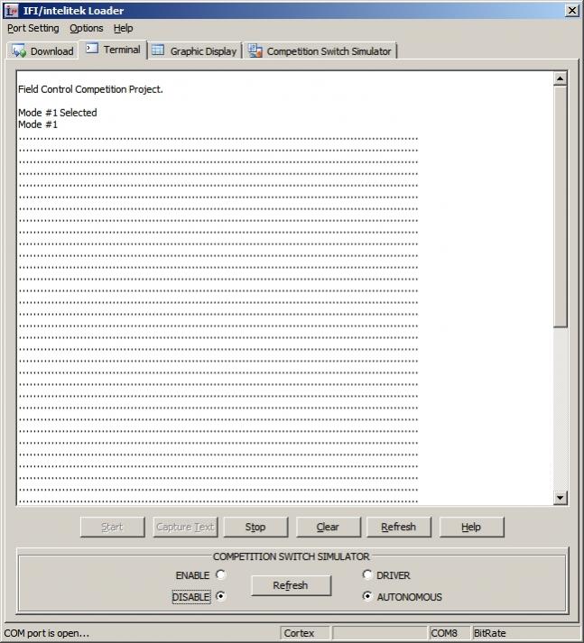

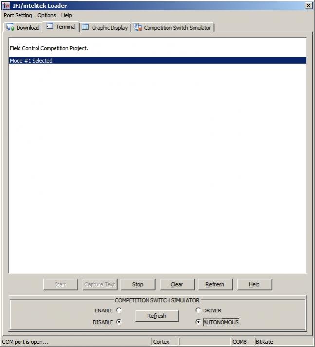

And just out of beginners curiosity what is the point of the “print to screen”

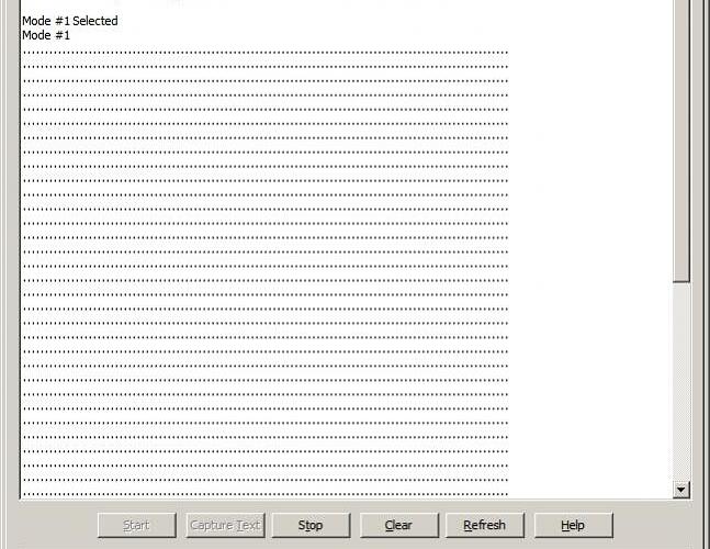

To see what my Code was doing, I needed to know Where in my Code the CPU was Executing…

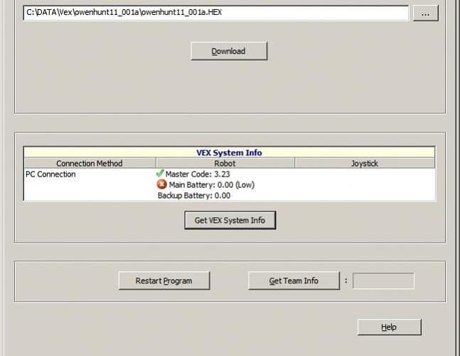

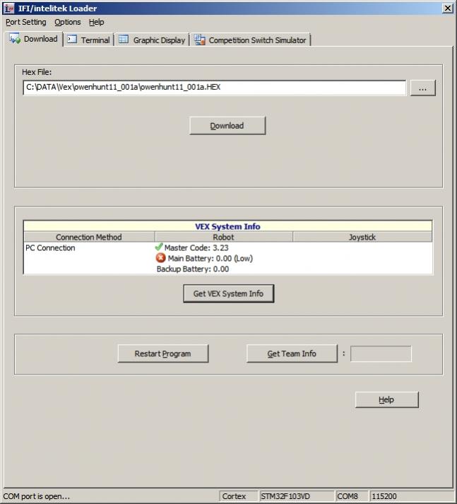

So the PrintToScreen will send Characters through the Programming Cable to a Terminal, either the one in the IFI Loader program or a standalone one like TeraTerm or RealTerm. I happen to use Both of them.
If I Plug the Cortex in to my computer with the USB A-A Cable and start the IFI Loader and select the Terminal Window, then Click Refresh on the COMPETITION SWITCH SIMULATOR, and Set DISABLE and AUTONOMOUS I get a Screen like this:
[ATTACH]7164[/ATTACH]

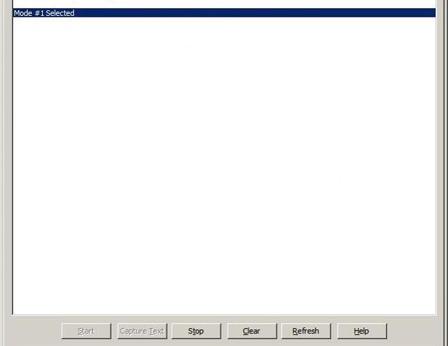

Pressing the Bumper Switch in Input #7, gives this Message in the Terminal Window:
[ATTACH]7165[/ATTACH]
And when the ENABLE is Set, and almost Immediately Set back to DISABLED, you get this:
[ATTACH]7166[/ATTACH]
This is how I knew what my Code Was doing, and Where it was Doing It…

Test, Test and Test with a Real Field Controller… This ALL depends on the Global Variable [FONT=Courier New]autonomous_mode[/FONT] retaining its value between the Initialize Function and the Autonomous Function…

Yes, it is one of the Oldest forms of Debugging…
Interactive Debuggers are very handy too, but EasyC doesn’t have any support for such things, RobotC does have something to use… I have not looked into the RobotC Debugger, yet…

This is the state of my Cortex, it is a NC2 Mod.
