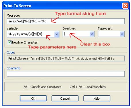

I am working in EasyC V4 trying to export a large array of data collected by the robot to my computer.
Currently, I record all the data into an array and then use the print to screen command to create an .h file that looks like this
Recording1.h
array[0]=10;
array[1]=3;
array[2]=5;
array[3]=2;
etc.
In the end, I have multiple recording files (recording1.h, recording2.h, etc.) and, based on an LCD menu picker that runs when the robot is disabled, one is included when the robot is enabled using #include.
For example

The problem I am having is that my recorded data array is so large (up to 26400 values) that it takes FOREVER to print these values since each value requires 6 print to screens and 6 Wait commands. ( only 7200 values takes nearly 20 min to print) This is because I am forced to put in Wait commands in between each Print to Screen function to make sure there is no data lost.
Is there an easier way?
Does RobotC offer a better or quicker solution?

Why 6 print to screens? Surely each line only takes one. Mark is correct, no point printing the array…] = … each time, post process the data if you need to do it that way.
Also, why not just make them statically initialized arrays
int array] = {10,3,5,2 etc…};
It’s probably less memory than having the code individually initialize each item. Every file is included the way you are doing it, it’s not conditional compilation, not to mention having an included file in the body of the code is frowned upon (well by me anyway).

The reason it’s taking 6 print to screens per line is that I am using a multidimensional array and each PTS only lets you send one variable (that i know of) so I have to print:
array[x
][y
][z
value
I suppose this could be cut down by using a single dimension array, but as it is now I’m having headaches double checking data is recorded properly.
I’m working on a project that should be as easy as possible for the end user to use. This is why my current code “writes the Code for me” :slight_smile: I would use your technique Jpearman of using the .h to initialize the array and then using a pointer, but it would require the end user to modify each .h file by choosing the name of the array and then they would have to keep track of the names used since you can’t initialize an array of the same name more than once (or at least I was getting errors, I don’t know anything about dynamic memory however).
It looks like this problem may be unavoidable however.

You can send multiple variables to a PrintToScreen. For example, if I understand what you are trying to do correctly, you could do this.
PrintToScreen("array%d]%d]%d] = %d ;", xi, yi, zi, array[xi][yi][zi] );
You can do this in the dialog box for PrintToScreen but it’s not obvious how, let me post a screenshot later. It’s easier to just use a line of user code.
Edit:
Here
[ATTACH]7300[/ATTACH]
Oh…wow, that will definitely help! Now the method you suggested only prints out 3 or 4 character per array value (2 or 3 numbers and a comma), whereas I could just stick with the method I am using now and Use one single PTS command. However, this prints out maybe 4 times as many characters per array value.
