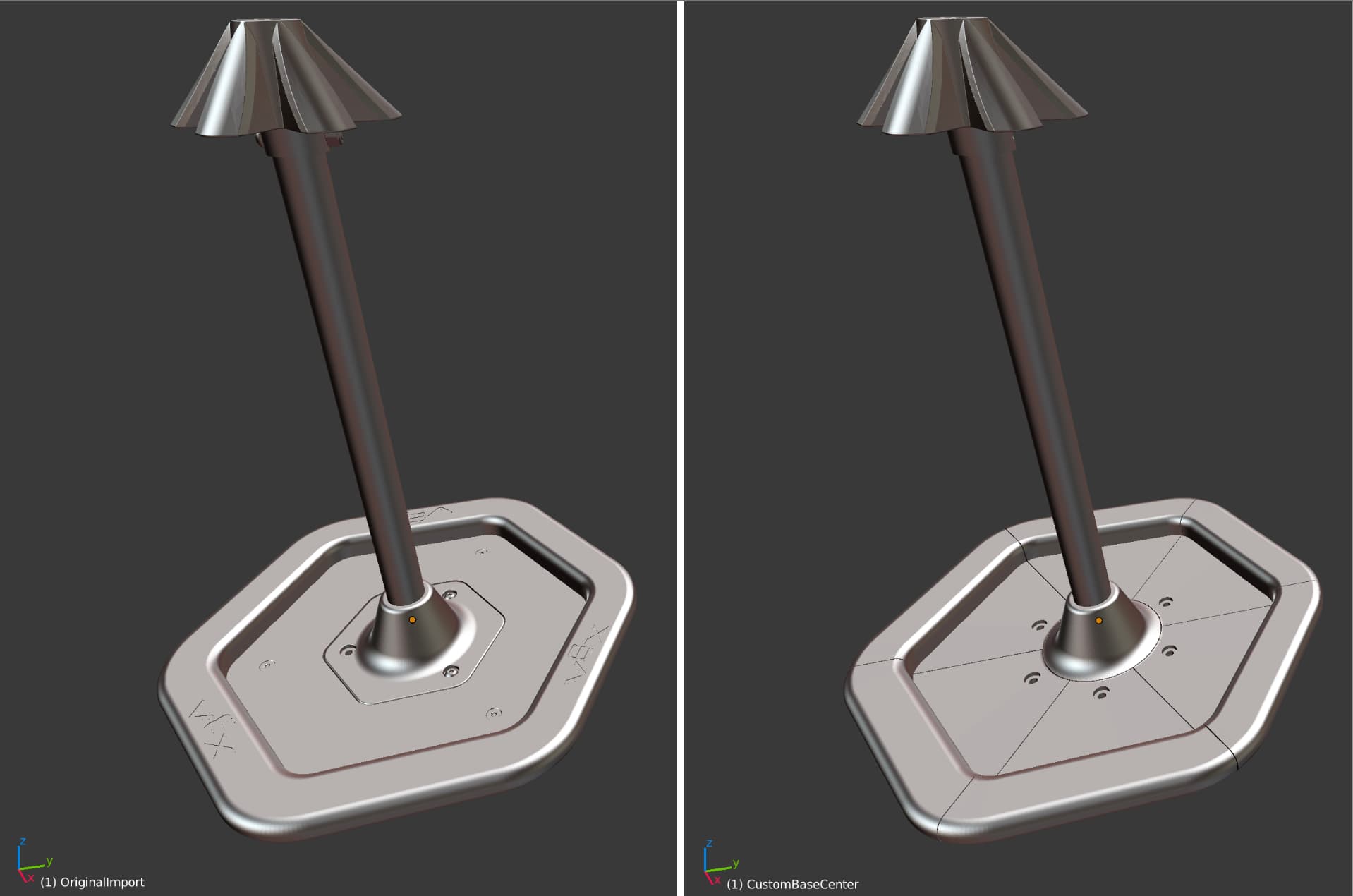

I wanted to 3D print a High Stakes mobile goal for my school, but the official CAD STEP file wouldn’t work. The base was too large to fit on the print bed and there were many small details that may not have printed the best. I brought the model into Blender and cleaned everything up, successfully printed and assembled it, and now I’m sharing it here in case anyone else might find the simplified models useful!

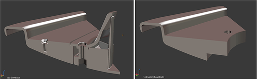

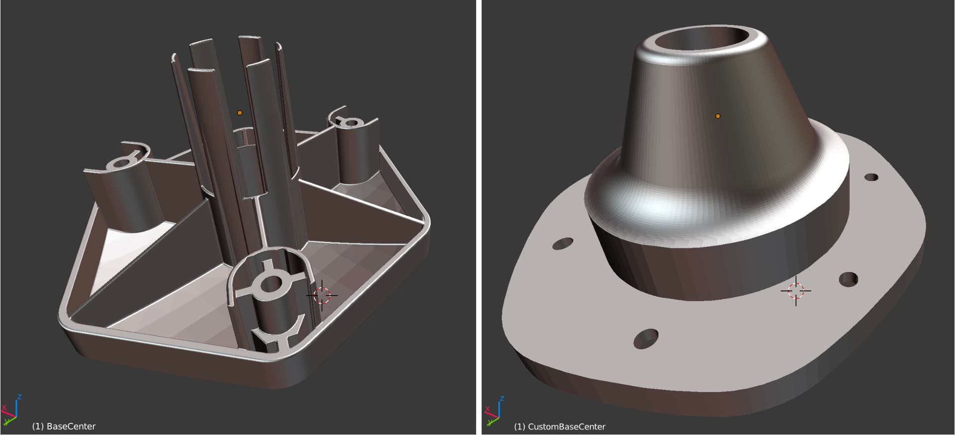

  • None of the important features that could affect robot building have been modified, just small decorative ridges and the internal structure that connects parts together.

  • I would recommend slicing the sixth base model with the bottom of the mogo facing upwards. I printed the first one with the bottom facing down, and it ended up being quite difficult to get the support material out of the rim as well as leaving a rough texture on the bottom of the base.
  • For screwing each sixth base to the center piece, I found that 7/8" screws and nyloc nuts worked the best.
Pictures of the original and simplified CAD models:
