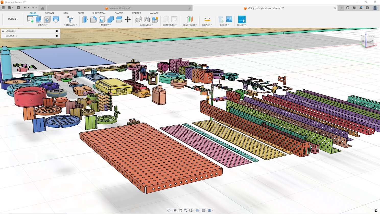

Looking at the size of the latest CAD library release on the forum, I wondered if anyone would like a copy of my simplified CAD collection in a single file. Here’s a work-in-progress, simplified, visually uncluttered and much lighter CAD library for VRC. 4.3MB zipped STEP file
u89djt VRC parts 240107.zip (4.2 MB)
This version is still missing the most recent parts, and you’ll see that a couple haven’t been fully simplified yet.
I’ll add the latest parts when I get to it and repost - they’re scattered across my other files in various stages of completion.
My aim in this is to be as small as possible in terms of data, and as visually uncluttered as possible so I can switch on a hidden-edges view to examine how things line up and not be met with a juddering mess of lines.
So, the parts look different because they have round holes and sharp corners, but I find they work really well for prototyping.
I won’t be supporting this library as such - you go ahead and do whatever you like with it. If an individual or group would like to turn this into something that gets released over time, do just take it whole or in part.
If you don’t like the simplified look, preferring the official CAD, but also want easy hole centres without needing to carry sketches around with every part, here’s a suggestion: an ellipse on the centre of the square can match one of the corner fillets quite well and gives a point to align to for bolts and shafts when you hover on the main surface, or on the elliptical fillet you’ve created.
Here’s the fusion file I built that example with.
hole modification.f3d (2.3 MB)
It’s amusing to note that it’s more than half the size of the whole simplified library. I haven’t built anything serious with this method as I’m happy with circular holes, but maybe this will be useful.
So, over to you!
