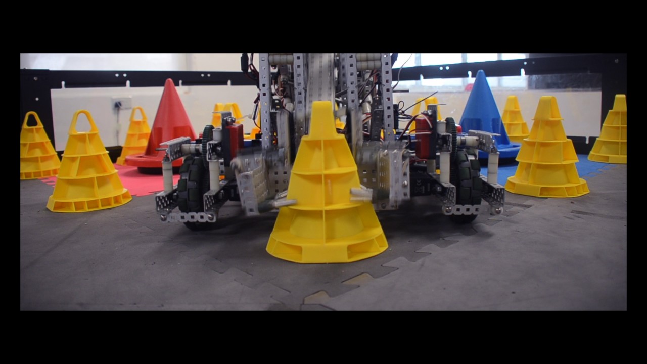

After a busy school term and tight schedule after Singapore Vex 2017, 8068 is finally able to reveal the robots we used during the competition.
In this thread, we will be giving information about 8068 E and G, both designed to be offensive robots.
8068E:
Robot Specification:
Base:
6 Motor Turbo gearing (4" Omni Wheels)
Lift:
6 Motor Speed gearing 1:5 RD4B
Limit:
Mobile goal: 16 cones
Stationary goal: 10 cones
Cone Intake:
Passive intake made out of rubber links and standoffs
Mobile Goal Intake:
2 Aluminium C-Channel attached to the RD4B
Consistently scores mobile goals:
3 cones in 20 point zone
7 cones in 10 point zone
8068G:
Base:
6 Motor Turbo gearing (3.25" Omni Wheels)
Lift:
4 Motor Torque gearing 1:5 RD4B
Limit:
Mobile Goal: 19 cones
Stationary Goal: 14 cones
Cone Intake:
Pneumatic activated claw
Mobile Goal Intake:
Incorporated into the claw design
4-5 cones in 10 point zone
Feel free to ask questions. We will try our best to help! :smiley:

Could you possibly show us a video of your G bot scoring mobile goals into the 20 point zone? Thanks! :slight_smile:
The mechanism of lift for 8068G is the same for both the 10 point zone and 20 point zone
I’ve uploaded a video of it putting in 20 point zone and another video of it putting in 10 point zone, the difference is that it crosses the 10 point pole to put the goal down in the 20 point zone.
Thank you very much that was very helpful! Good luck!
