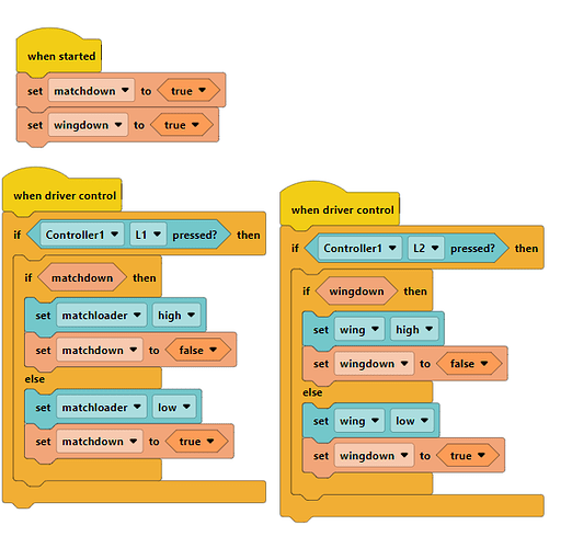

so we were wondering if it would be possible to do this with block code. right now we have this:
but we dont have access to our robot right now, so we were wondering if it would work,thanks!
This won’t work. Both if statements will only run once and then never again. Add a forever loop around each if statement to fix it.
