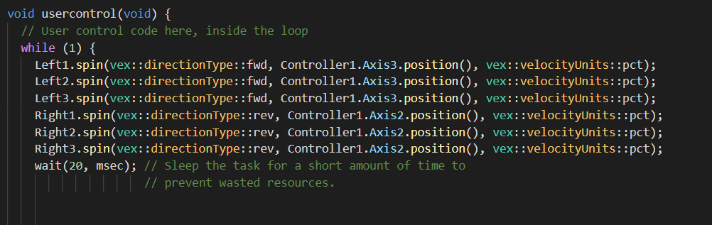

Six motor drive
How should I program six motor drive using c++, just added it for regionals

our driver prefers tank drive, would this code work?
Yes, that will work. It’s probably better to use voltage instead of percent, but this is fine.
