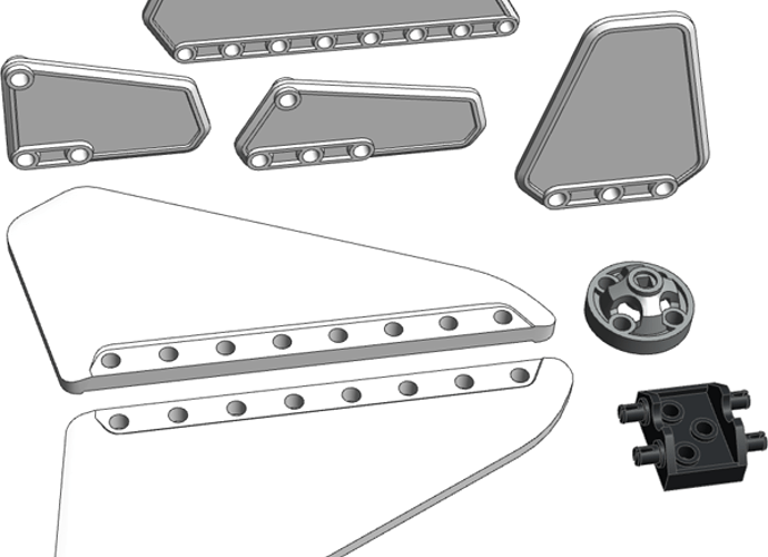

A long time without updates… the wait is over, a few new parts for Snapcad/LDCad for VEX are now available! Get them here.
