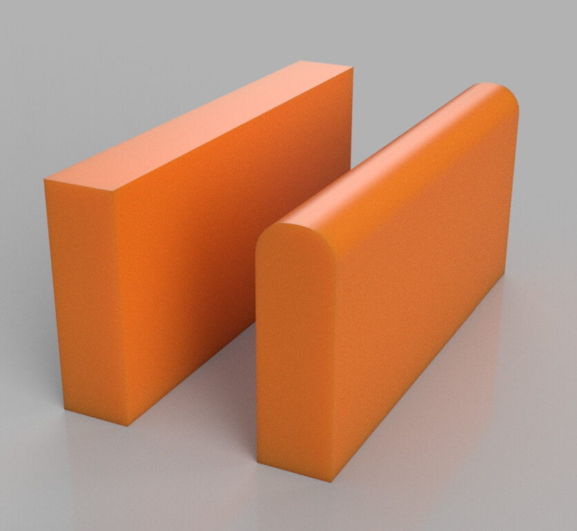

Sand a nose on it. If you can use sandpaper on a sponge, cup it over the end of the sheet and move along the whole face of the end of the plastic with it squished over and it’ll take off the sharp edges. If you need to use a flat block, you’ll have to control the arc of motion yourself. You can do it before you shape the sheet for attachment to the robot.

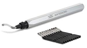

If you have one of these it takes the burs off very well
what is this tool. Could I get a name or link
Its a deburring tool, that’s not the one we use specifically ( I just used it as reference) but would probably work, I don’t think the brand matter too much here, I think most of the brands have them, for my hand tools I like the Kobalt stuff but honestly whatever’s cheapest here is probably best. We have one in our shop that is a generic red one that’s great so I wouldn’t stress there.
Weird coincidence… one of my roboteers was insisting we buy a deburring tool (I always just used a knife, file, or sandpaper). I finally gave in and bought this [one].
(AFA Tooling - Deburring Tool with 10 Extra High Speed Steel Swivel Blades - Works on Metal, Resin, PVC Pipes, Copper, Plastic and 3D Printed Edges - Plumbing & 3D Printing Burr Removal Reamer Tool: Amazon.com: Industrial & Scientific).
There are many other options too. It just came in this week and he couldn’t be happier,
