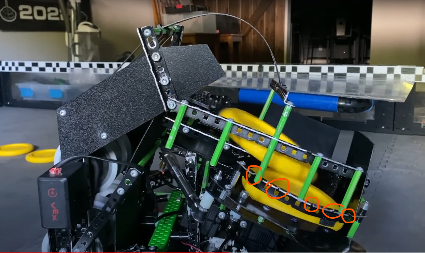

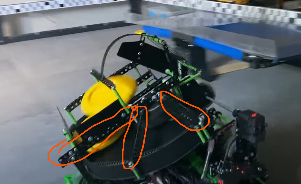

I am relatively sure they used relief cuts in intervals along the 1x1 angle to bend the metal in sections.
I am relatively sure they used channels with standoffs mounted radially from the flywheel, then put lexan inside, forming a curve.

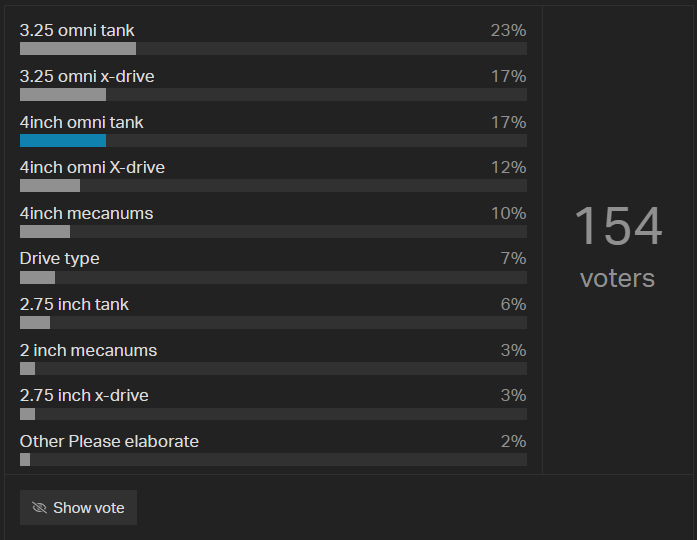

Why then, I ask you, do world champion teams never (to my knowledge) use mecanum? If it’s inherently better, why do teams use omni wheels at all?
I see the argument that there isn’t room, or that the game isn’t really designed for it. But there is no way that is true for all past games, so I don’t see the validity in that.
One last note, it seems that most people don’t agree with your reasoning
I don’t think there is anything inherently better about mecanum wheels either, but there are some advantages and disadvantages to them which make them a very viable and competitive option in the right hands.
There are many reasons why mecanum (and to a greater extent, all non-tank drives) do not typically win worlds. Like you mentioned, many seasons are less suited to holonomic drives. Holonomic drives also require a lot of investment before they benefit a team. You have to put in a lot of additional programming and driver work to make them competitive, and the vast majority of teams make the decision to instead focus efforts on refining a simple robot. Simplicity is almost always when ends up winning in the end, just because by the very nature of vrc, having a super consistent, simple bot with a ton of driver skill will usually win in the end. As to why mecanum drives are generally disliked, I figure there is a number of reasons as well. Many teams are unable or unwilling to put the necessary effort and skill into properly using holonomic drives (which is totally a competitive and viable decision to make, I would never recommend holonomic drive to a team that prefers tank.) Also I see a lot of people bashing mecanum wheels in particular, which causes teams who have never even tried them to just assume they must be bad.
