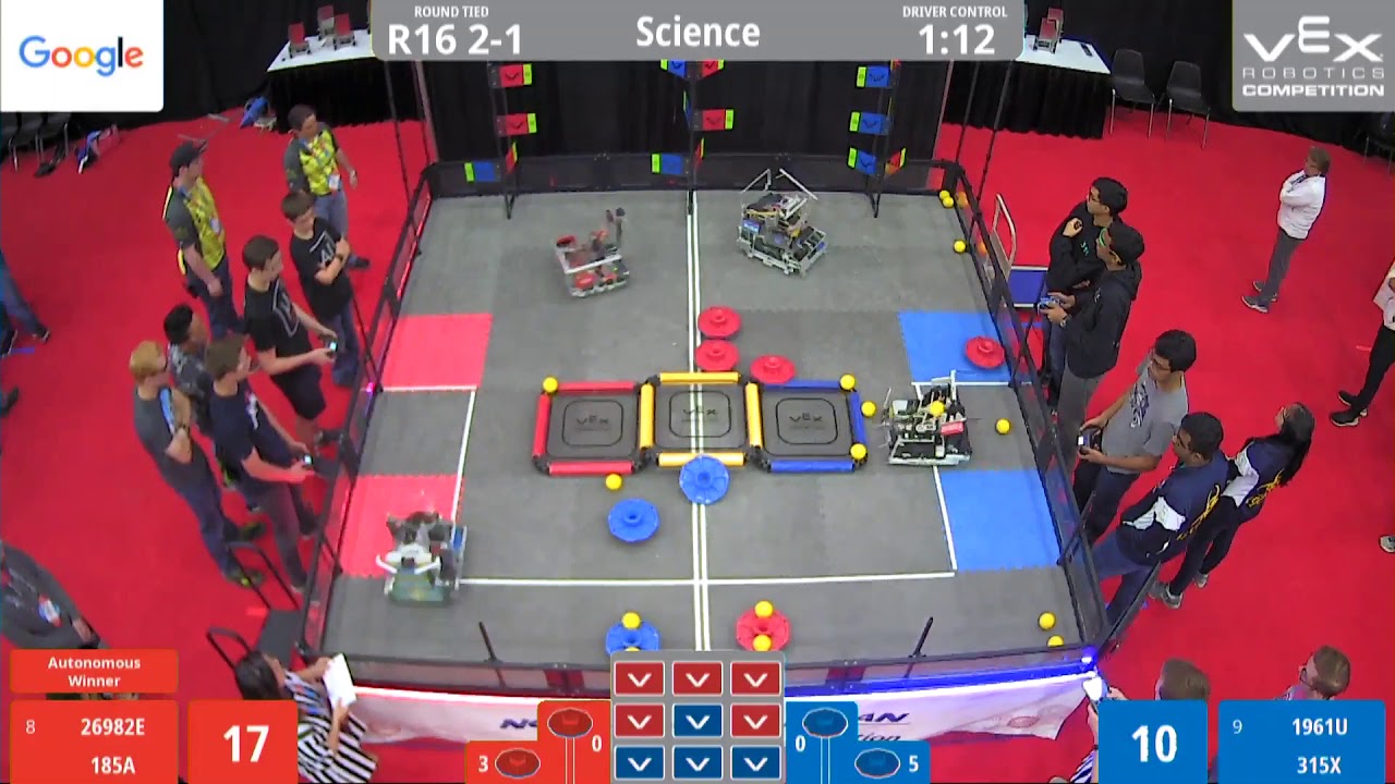

I’m surprised that out of all of the turret talk, nobody bothered to mention 185A from Turning Point. They arguably had one of the most functional turret system for aiming and firing… A video of one of their matches is posted below:
Something like this might seem viable if teams figure out how to load discs in a similar manner, alongside fitting a proper flywheel (or a slapper, who knows) for shooting the game objects.

One thing I will point out here is that the turret didn’t make them any faster.
They could have just as easily made those corrections with the drivetrain in the same time. It didn’t make them any more accurate either, as they usually missed when they used their turret for quick aiming.
It seems to me like it is a waste of a motor if it’s not making you any faster. I see more value in putting that last motor on your flywheel, making you faster in that you don’t have to wait at all between shots for your flywheel to spin up again.
